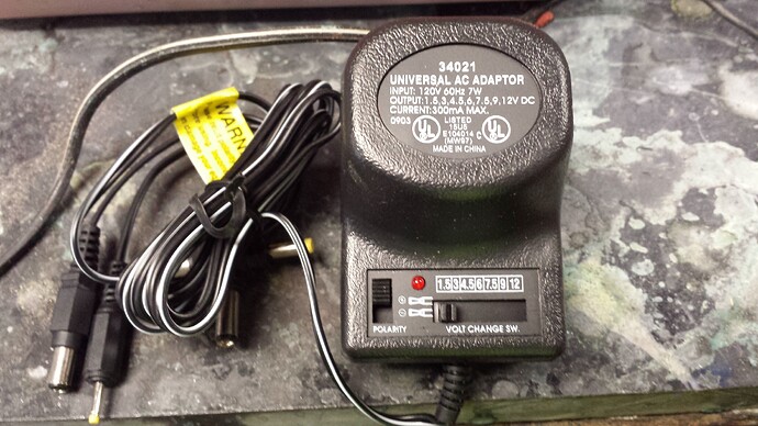

made a new blend 1 part copper to 4 parts graphite also thinned out the coating. So far application was much better. Also dug up a small variable transformer 1.5 to 12 volts rather have more amps but I will make due.

3.7 volts 340 milliamps time to plate 1 hour. The plating was thin .03mm due to short plating times but it was a very durable coating held up to sanding with 340 grit and fine steel wool. here is before and after cleanup

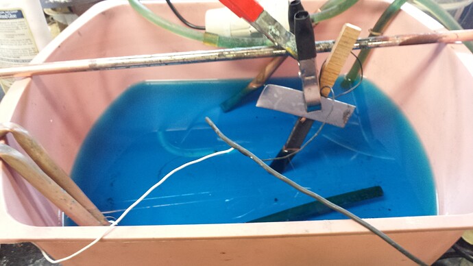

I made my own plating solution and plating set up but here is a popular site that carries the supplies and kits. Making my own solution cost me around $25 and would allow me to make about 5 gallons witch is over kill. If you keep the solution clean by filtering a batch should last around 2 years.
http://www.caswellplating.com/electroplating-anodizing.html
My plating solution consist of distilled water sulphuric acid copper sulphate and saccharin 550 (sweet and low). The amount of acid I use is just enough to do it’s job and not eat flesh from bone more would be faster but I am going for slow and safe.
