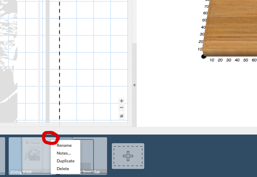

I get that. You want to perform three operations using two tools and decide cut sequence.
Easel don’t support that so you need to dissect the carve into individual operations.
Follow Darrins workflow, its good.
(Instead of cut and paste, I suggest you click “Duplicate” at the workpiece from the bottom pull-down meny)
