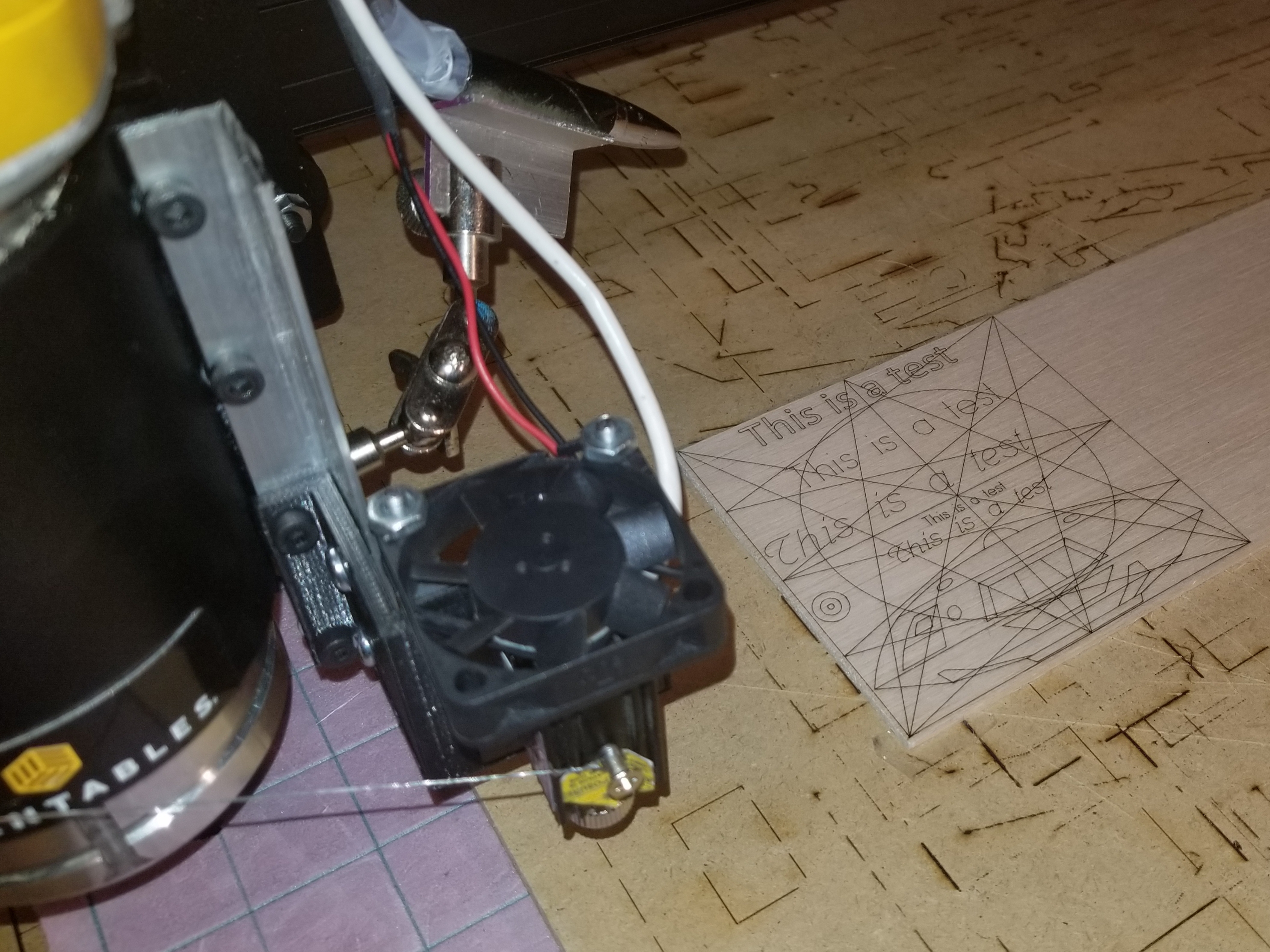

I’m getting jagged edges on a test pattern generated with JTech Photonic 3.8 Watt laser on X-carve.
This is after tuning pots, adjusting V-wheels and tightening belts (per recommendations found in forum).

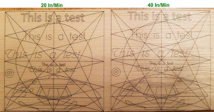

The problem is barely noticeable when the test pattern is generated at 20 in/min.
However, same pattern generated at 40 in/min shows major waviness/stair stepping/jaggies, even on some vertical lines, and especially text. Is there some other variable I haven’t considered?
I tried belt tightening (and loosening) - no major impact.
I tightened and then loosened v-wheels until they barely spin per instruction - no major impact.
Lastly I adjusted X and Y G-shield potentiometers (I have original X-Carve) to 75% of max. (Really thought that would finally fix issue. But no joy!)

Laser mount wiggle??? That is what increasing speed seems to indicate.
Just noticed you are only using 1 screw to hold the mount. Not good.

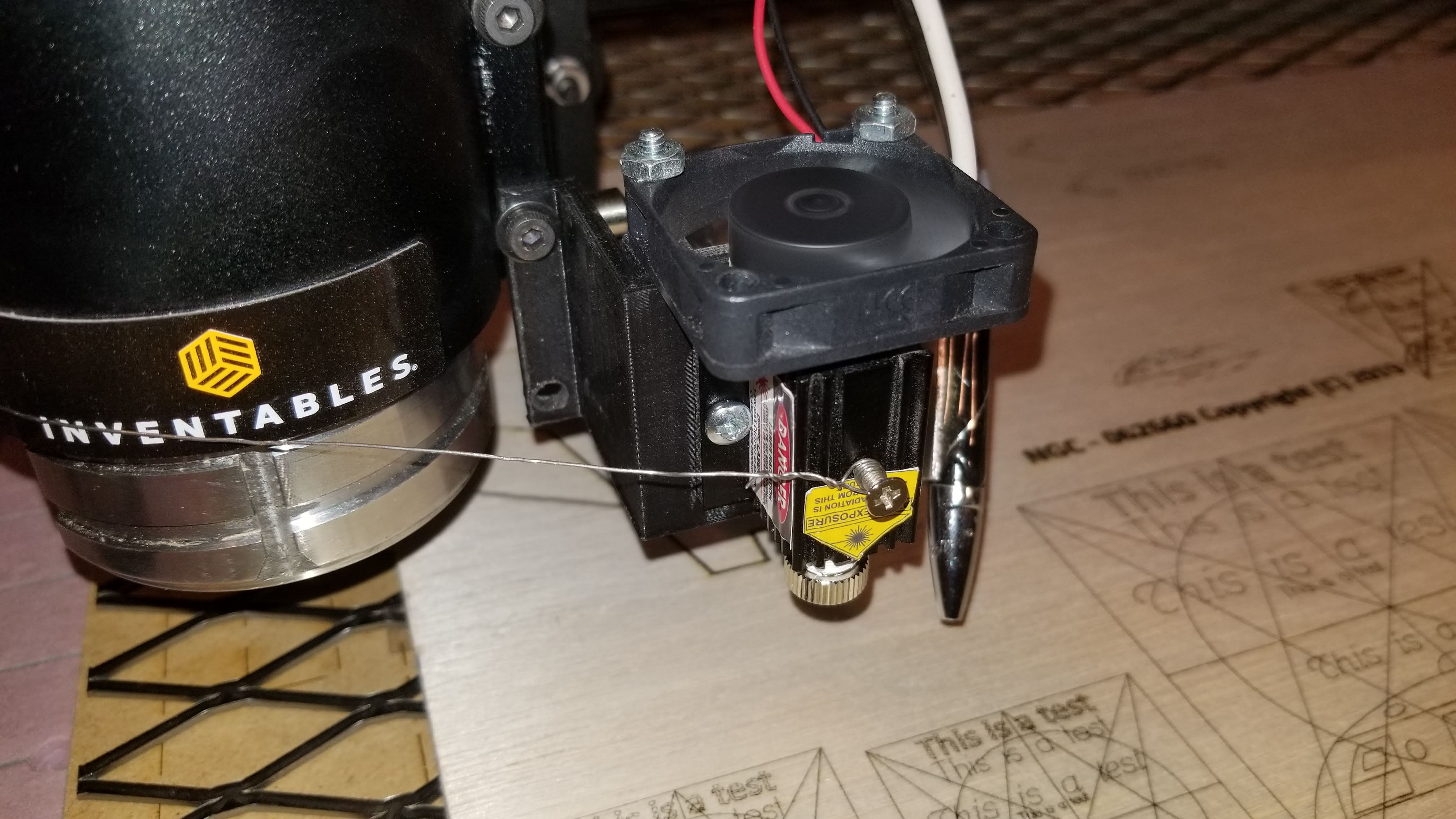

I spoke with Jay of JTech last week and he said I should adjust laser to between 1 and 1.5 inch focal length. Which I did to address more efficient cutting (not to address this topic). I get a much finer laser point and improved cutting. Current focal length from bottom of focus ring to material is 1.48945 inches. (Was 2.5 before change).
I was using 2 screws with the standard mount before before I lowered the focal length. Still had the issue when focal length was at 2.5 inches.
I damped vibration with the wire shown going from laser to screw on other side of Dewalt spindle mount.
Seems pretty sturdy but I can buy in to vibration as potential cause.
I’ll make a new mount and see if that fixes the issue.

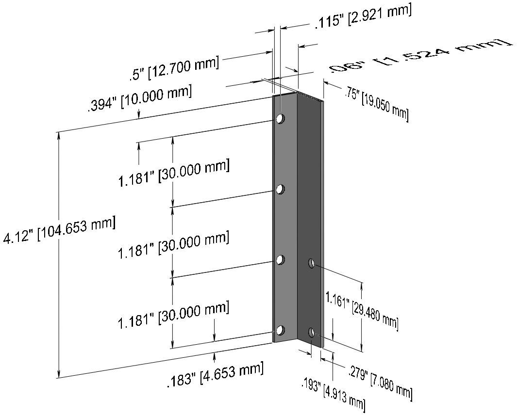

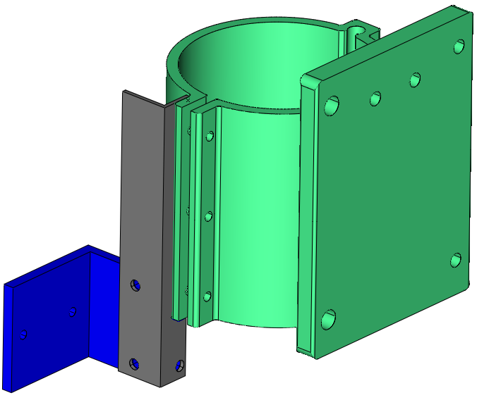

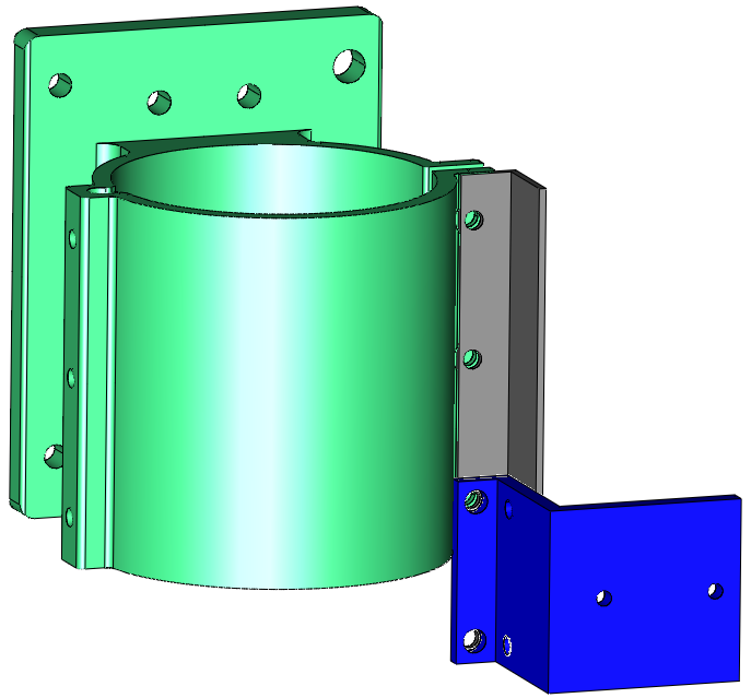

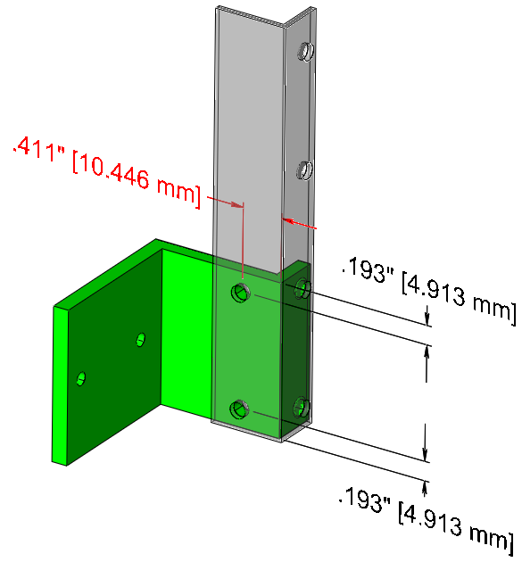

I’m designing new mount right now using a .5 x .75 x 4.25 aluminum angle. That should hopefully minimize jaggies.
Here are pics of custom JTech Photonic 3.8 Watt Suckit™ Dust Boot X Carve Side Mounting Kit adapter I’m going to make.
Dimensions
Dimensions for Suckit Mount with Added Holes
I made the mount shown. It helped a lot but there still some jaggies. I concluded with further testing that vibrations from the inertia generated by sudden changes in direction, acceleration and deceleration is causing the jaggies.
So for the next test I dropped the the default UGS acceleration from 500 mm/sec^2 to 50 mm/sec^2 and kept the overall feed rate at 40 in/min and got the excellent desired results shown.
So bottom line, use a stable mount and drop acceleration for laser jobs where vibration is more of a factor.
Will set it back to 500 mm/sec^2 for end mills jobs.
