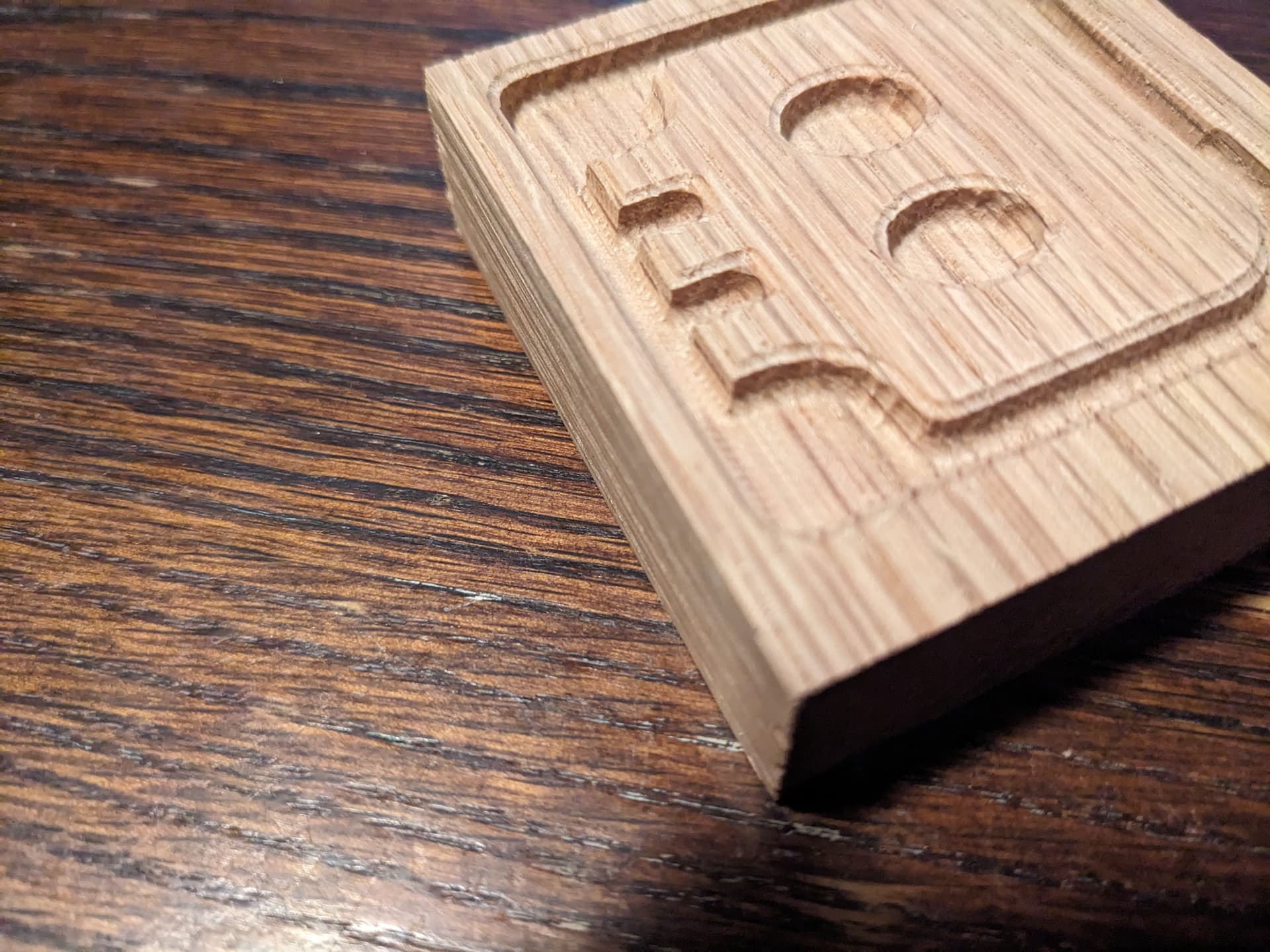

Unplanned small cut-in / bevel at top edge
If you look at the picture given, the top edge cut-in of the shape is meant to be entirely vertical, but instead has a small shelf / bevel / something. Which looks kind of neat on this particular piece, but I’m setting up to cut some molds, and they absolutely can’t have this.
Is this a known issue? Any ideas what could be causing it?

Comparing the output to the toolpath previews carefully, I’m more and more convinced that what’s happening is that while both passes are running correctly individually, the finishing pass in it’s entirety is running about .5 mm deeper than the roughing pass - which suggests that the problem might not be on the Easel side, but instead be somewhere in my workflow for the “re-zeroing the Z-axis” step of changing bits between passes, somehow (not sure how that could be flawed, given how straightforward it is, but it really appears something’s slipping down in the between-passes).

Carving this as 3d using the .stl i suggest selecting different bits, smaller for the finishing bit… also note that the workpiece thickness should be larger than the z size (plus the z position) but i noticed that your values are equal… but the material thicness must be LARGER so youll want to edit one of these values to make it so…

I was unaware of the thickness requirement! Will change that and take another run, see if that makes a change (I’ve already tried to re-zero with much greater care than previously to no effect; shelf remains).
For future readers with similar issue:
This particular issue is absolutely caused by having the material top surface and the STL top surface at the same height. As soon as I raised the material to 0.2 mm taller than the STL, the effect vanished.
