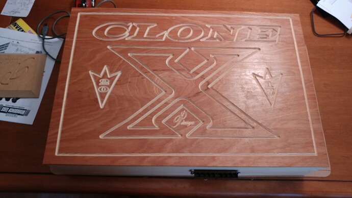

Those are awesome! You must post the easel project, I want to cut some now just for fun…:slight_smile:
I designed these in V Carve Pro, if some one will chime in and let me know how I’ll be glad to!
I actually use vcarve pro, so I can use the crv, however to use in easel I’m not sure, perhaps export as svg or dxf…
I loaded the ducts into the projects

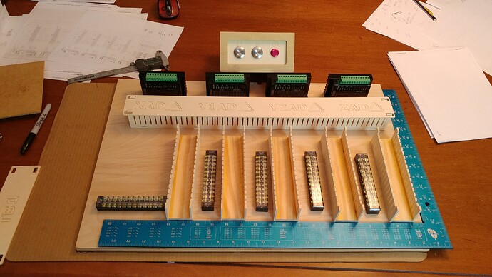

@PhilJohnson, I’m having a hell of a time getting 18 ga wire into the screw shield on the cheap controller, would it be ok to use 22 ga to the terminal blocks? Thanks greg
i bought the same one you used from adafruit.i’ve twisted them as tight as i could. always a few strands not in the hole. worried about a short between the terminals.
May try tinning the wire with soldier.
Tinning worked great, thanks for your help, almost have the arduino wires ran!
No horns or Demons, just getting there. Completely wired in the box. Hoping to have installed, up and making chips and dust! Thanks again @PhilJohnson and @LarryM!
