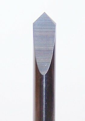

Is the actual cutting part 1/8"? Or is the shaft 1/8"? I would not bother with a 1/8" engraving bit for work like this. Wait for the 1/2".
Does your bit look like this?
Or this?
s-l400
That is some great information. Thank you so much. I really appreciate it.
The bit looks like the first one. I have the second one as well, but not sure when to use it yet. I know it’s for more detailed engraving.
That changes some. Since it’s 1/8", I’m guessing you have this one?
That one has a max cut diameter of 6mm, so math tells us that cutting more than 3mm deep will cause problems (with Easel generated toolpaths).
If you don’t have that one, can you share the exact bit you have?
