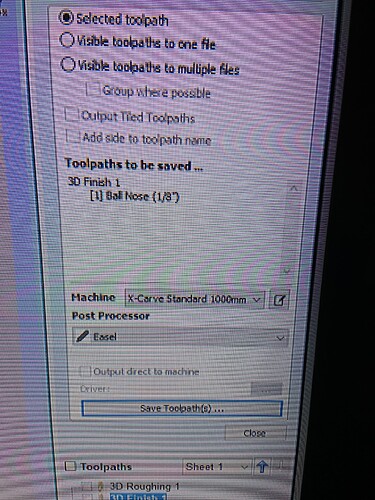

V Carve Pro 11 to Easel Issue
Exporting gcode from V Carve Pro and opening with Easel and it is blue, followed post processor installation instructions but nothings working.

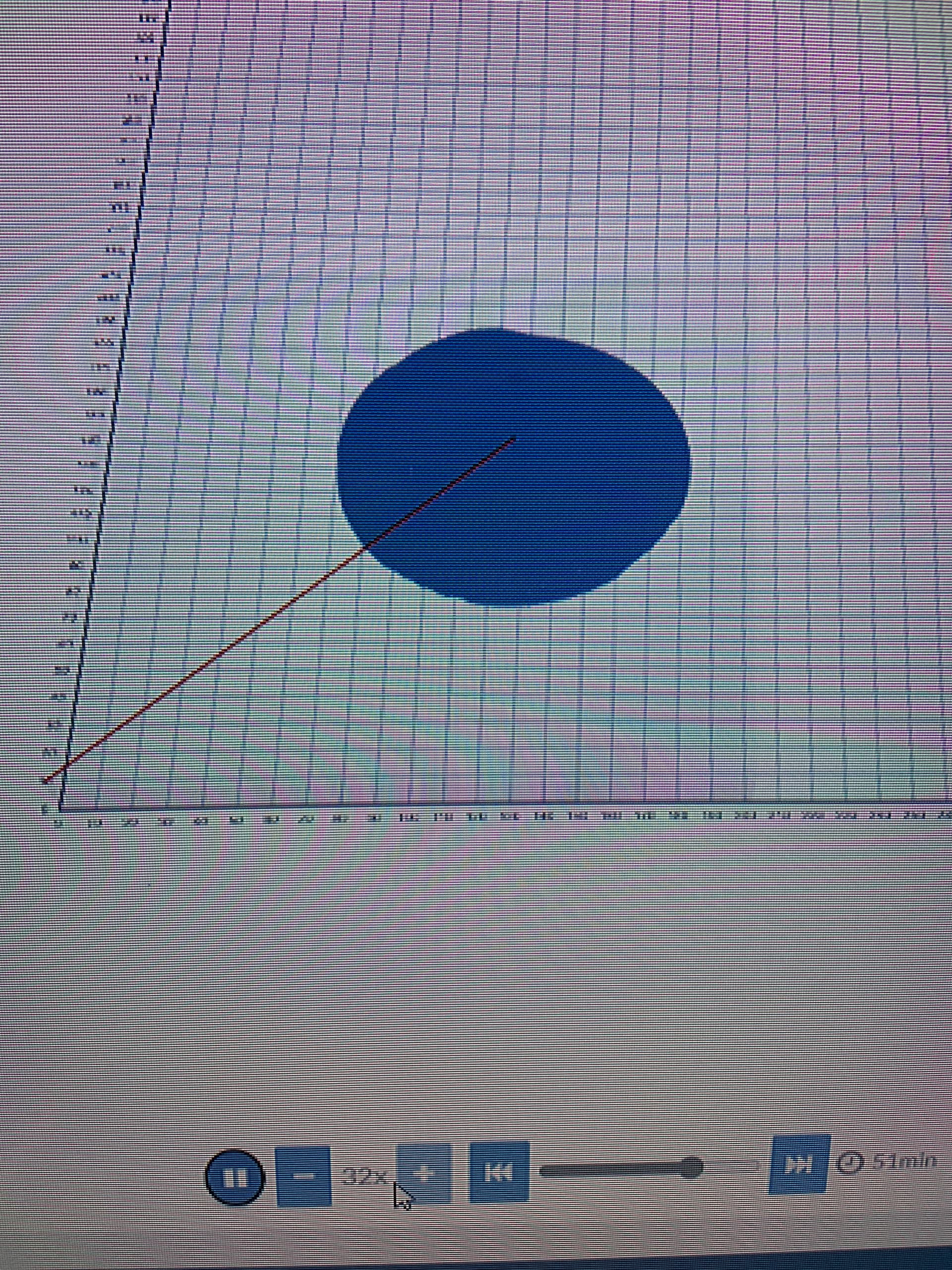

well, if you imported a gcode you will not see an image. the blue you see is the tool path.

It does for some CNC 's with intergraded and/or built-in controller, this is something the Xcarve doesn’t have.
The blue looks perfectly normal… the finishing toolpath has riny stepovers and that reaults in a covered blue lines…
Now whether you want the location to be that far from the 0,0 position?
I also use openbuilds control, great sender, ans the post processor it supports arcs (while easel as the sender wont do the arcs, which can make the carve times longer)
