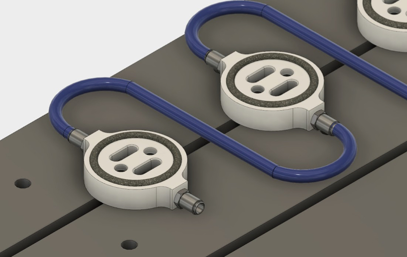

Alan, I just visited the Axiom site and saw this. A vacuum hold down method that does not need a vacuum table. I wonder how well it works? It needs a compressed air source to work, but that should not be a problem.

This company makes a vacuum hold kit for under $80
That looks like a pretty big step up from the X-Carve. I think if I get another machine, I will buy a mini mill and convert it to full CNC. Then I can mill metal with no problems.
This system looks awesome! And it’s not an insane price either! It would be neat to see someone implement this onto their machine.
The Vacuum pucks is something you can make yourself with HDPE. A couple months back I had to make a set of 8 for a specific job.
Pretty simple to make.

That’s awesome! They didn’t look too complicated, I guess you would just need the valving system and you’re good to go! Do you have any photos of the ones you built?
