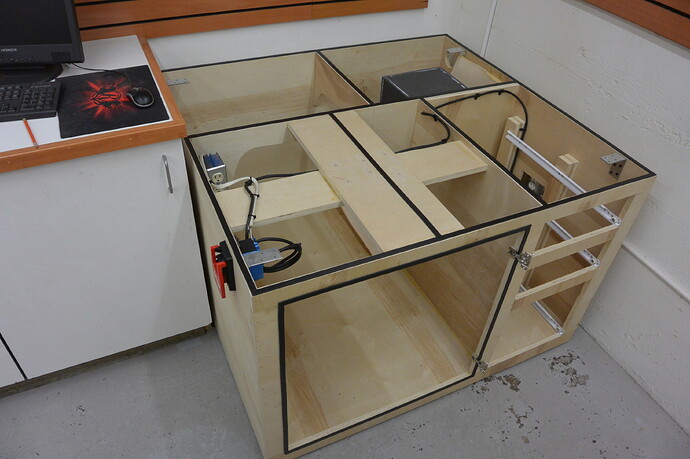

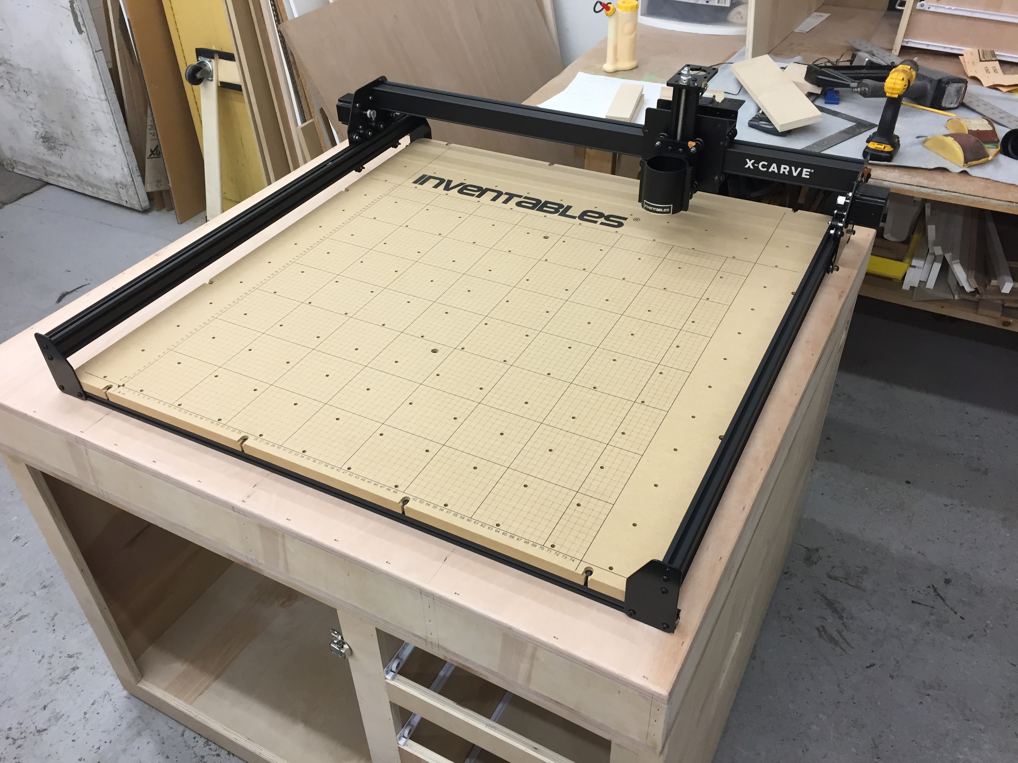

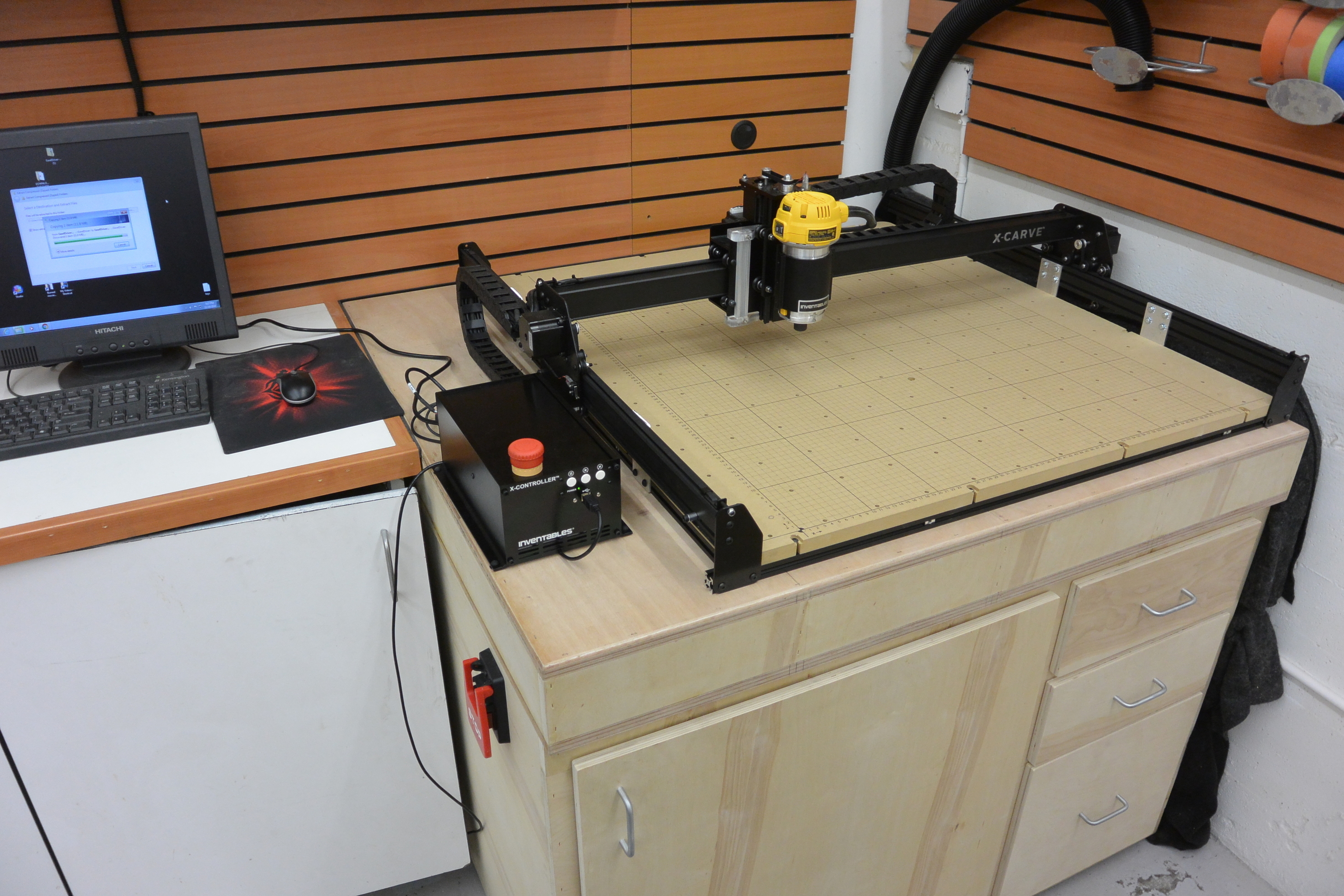

Just got my X-Carve, this enclosure and table is for a Craftsman shop vac. Post more pics tomorrow, appears to drop the noise a lot. Also have dust collector, just didn’t want to run it on this new setup, that may change depending on dB level.
Beat me to it! Plenty of designs out there for this. I plan on building one very soon! You can pick up noise cancelling foam for dearly cheap on Aliexpress and ebay. Just be careful with heating issues.
Whoa nice

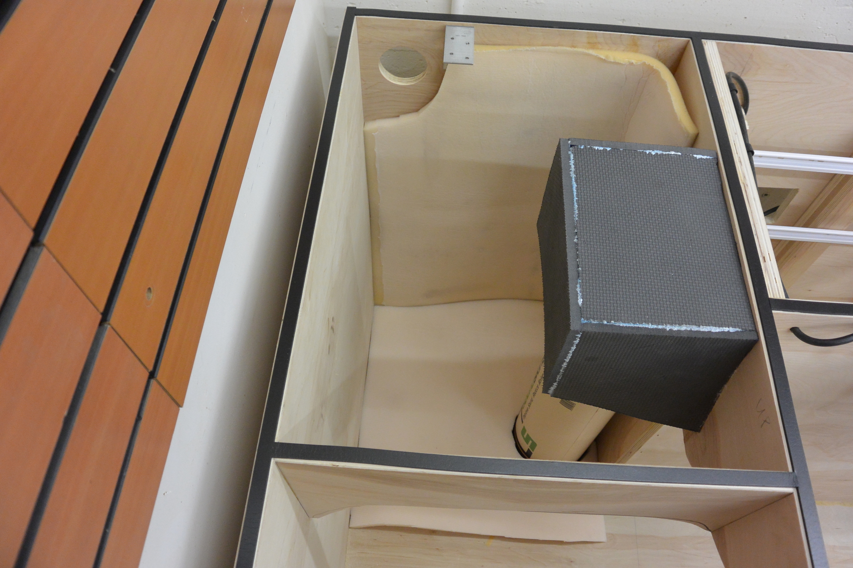

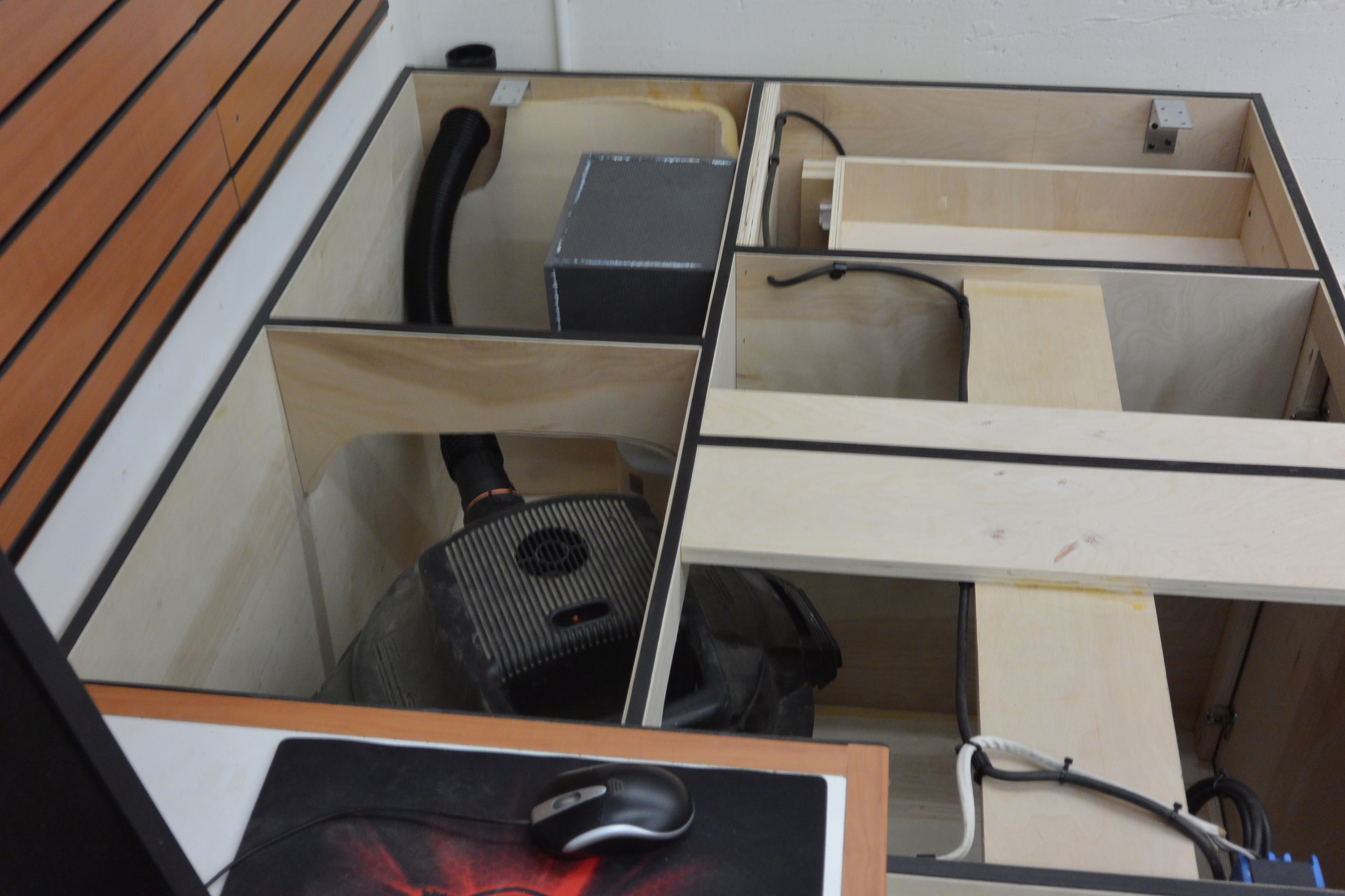

Got a chance to try out the initial noise levels today. Still have a few more mods to do, dropped the noise 12 dB’s so far ( keep in mind a change of 3dB is twice as loud or quiet). Sound level acceptable, but I believe adding more dampening material will make it better. Heat rises to the top of the enclosure, and sucked out the tube and blown out the bottom of the enclosure.
Nice table! I wonder what the difference in db would be if you used that black noise dampening triangles
