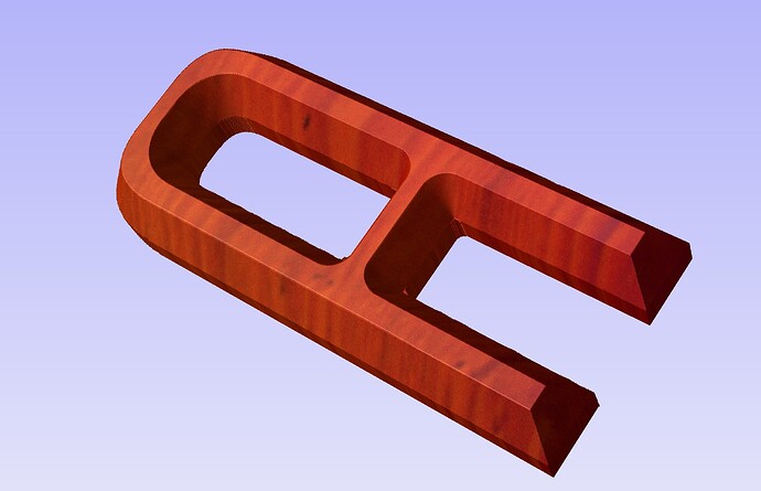

Vcarve hidden secret!
Does it stay enabled for that .crv file in the future when you open it subsequent times?
If you don’t have very fast processor it is really going to slow down how fast Vcarve updates
Wow. Makes a HUGE difference!
What I would like would be to move the "camera"side to side when I’m looking at the tool paths. If I zoom in, it only zooms into the middle and while I can rotate things a bit, I can’t get a good zoom into the outer edges of a project.
So, I guess we can’t enable this on existing .crv files?
You can use the wheel of your mouse to zoom in. HOld both mouse buttons down to drag your rendering around. Should fix you up. You can cut your designs from old CRV’s and paste into a new file.
Yes you can on existing files, just hold shift, click the menu item edit, then Job Size and Position.
Works for me.

Maybe it’s been already said, but anytime you hold the shift down and hit the work dimension button, you can get up both 7x and 50x resolution in VC 9. It doesn’t have to be newly created projects. If you have an old project laying around, give it try.
Yep that works, always thought I would have to to create a new project.
Another thing what I would call a hidden secret is the option to set the amount of fading when you try to trace an imported bitmap manually with the drawing tools.
rightclick on the imported and selected bitmap then Object Properties and a slider pops up where you can set it even to 0% fading. Makes it easier to see what you want to trace.
