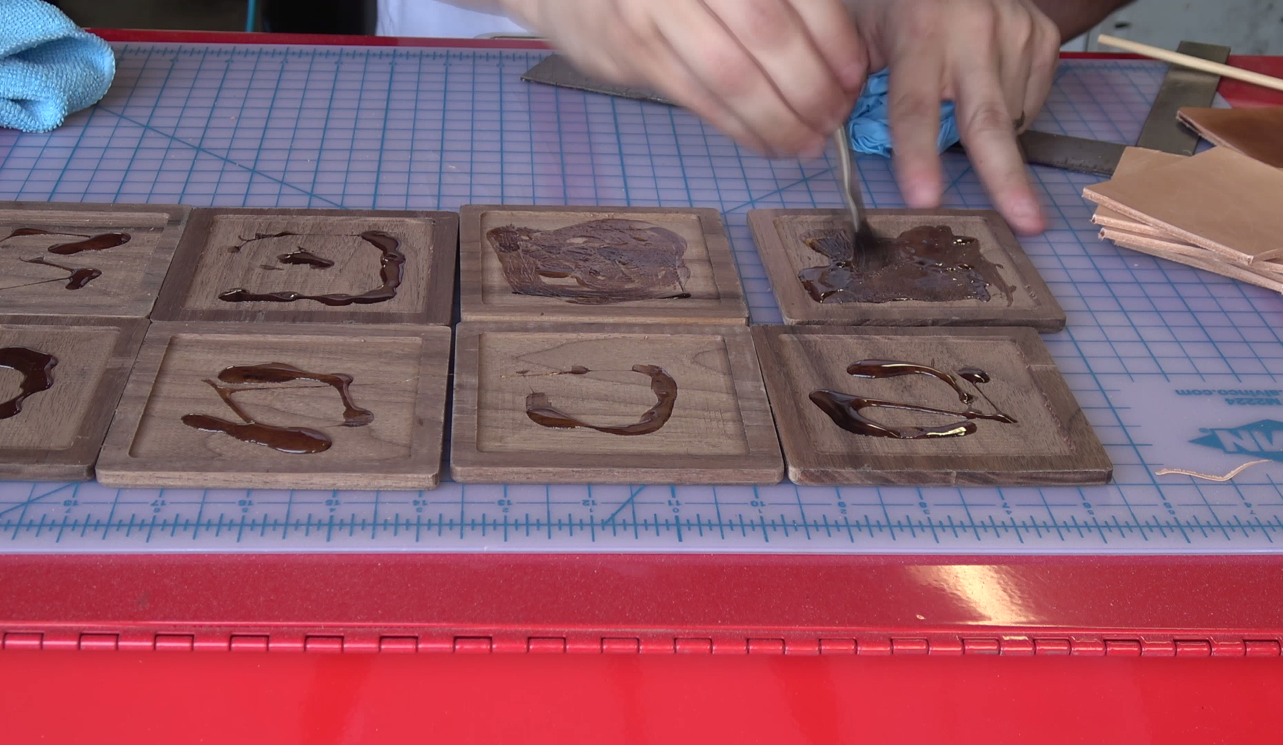

Applied some barge cement:

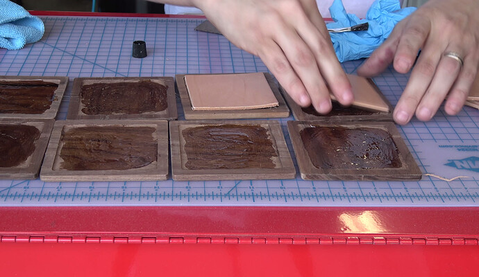

Glued on the Leather:
And just held it on in place with some chunks of aluminum I had laying around:

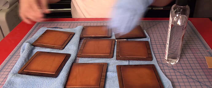

I used mineral oil on these:
I also decided to oil the leather itself with the mineral oil… After a test I thought it gave it a cool aged look:
Here’s the finished result!
