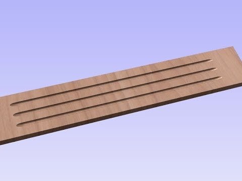

I want to cut a line, 10" long, start at a cut depth of .02, and end at the finish of the same line at .05, in a single pass; So the Z axis actually goes deeper as the bit moved down the cut (cut pass will be deeper on one end, than the other). Is this possible?
Check out this app in Easel. You can tweak it to get what you want.
Shim one end up 0.03?
Thanks mark, want to try and stick with the software control measure. I’m going to see what the app above does
I used the app a couple times I had to change my stepover, and run a few tests to get it right
