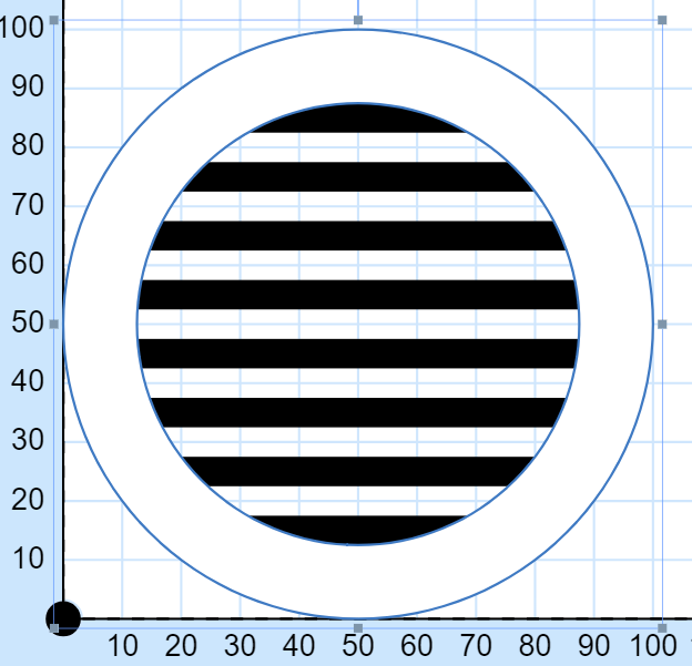

Want to make repeated 1/8 straight cuts
I want to make this. How do I make repeated 1/8 cuts like this?
6 steps…
Start with outside circle
Then inside circle (desired size of your grill)
Merge the two
Create the grill
Bring outer to front, set cut depth to zero, select all, then combine
Create a new outer, set depth to full and outline cut.
All done!
Great answer! I often forget about the usefulness of combining.
