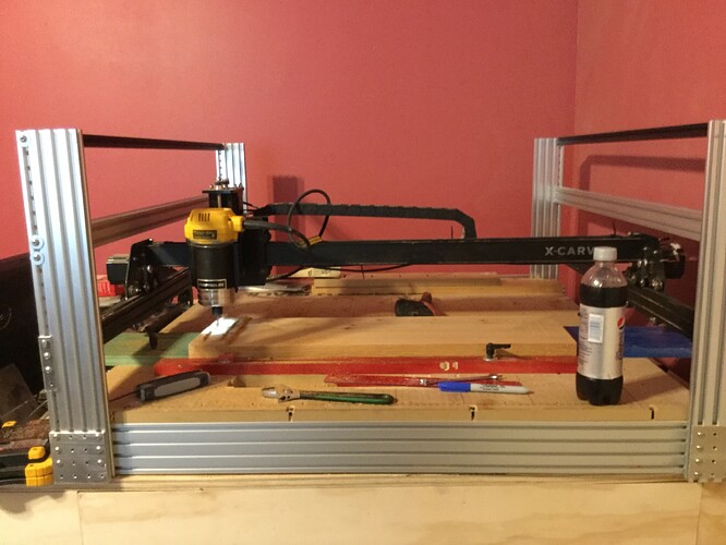

Added new uprights to expand my ability to do thicker projects. The second rail will add about 5 inches but the rails can be lifter to about 480 mm. Ran out of screws so I sent off for more. Added the top bars for extra bracing. Haven’t put on the front braces yet will do so once the screws come. Next to finish the Z axis with new one. the base is all 20x80 mm. I added a slot so I cant do dovetail boxes.

I plan it, as soon as the screws are shipped. Have not needed extra bracing on the two projects I have done but still plan on it, I also have plans for an exoskeleton to be added at one point.
wow, that is a great idean. now how do I do that. Got any ideas.
