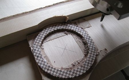

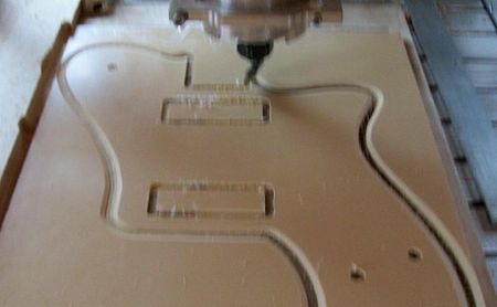

Many times I use double sided duct tape to hold my work down and usually use a layer of corregated cardboard under it that’s almost 1/" thick. I set the final depth to the cardboard so I don’t cut into my router surface. The tape will gum up the bit, so I clean it periodically.
Other times I’ll leave about 1/32 of an inch of wood left holding down the part, and remove that with a trim router and a flush trim bit. It depends on the size of your parts.
cutting
rosette
This one
