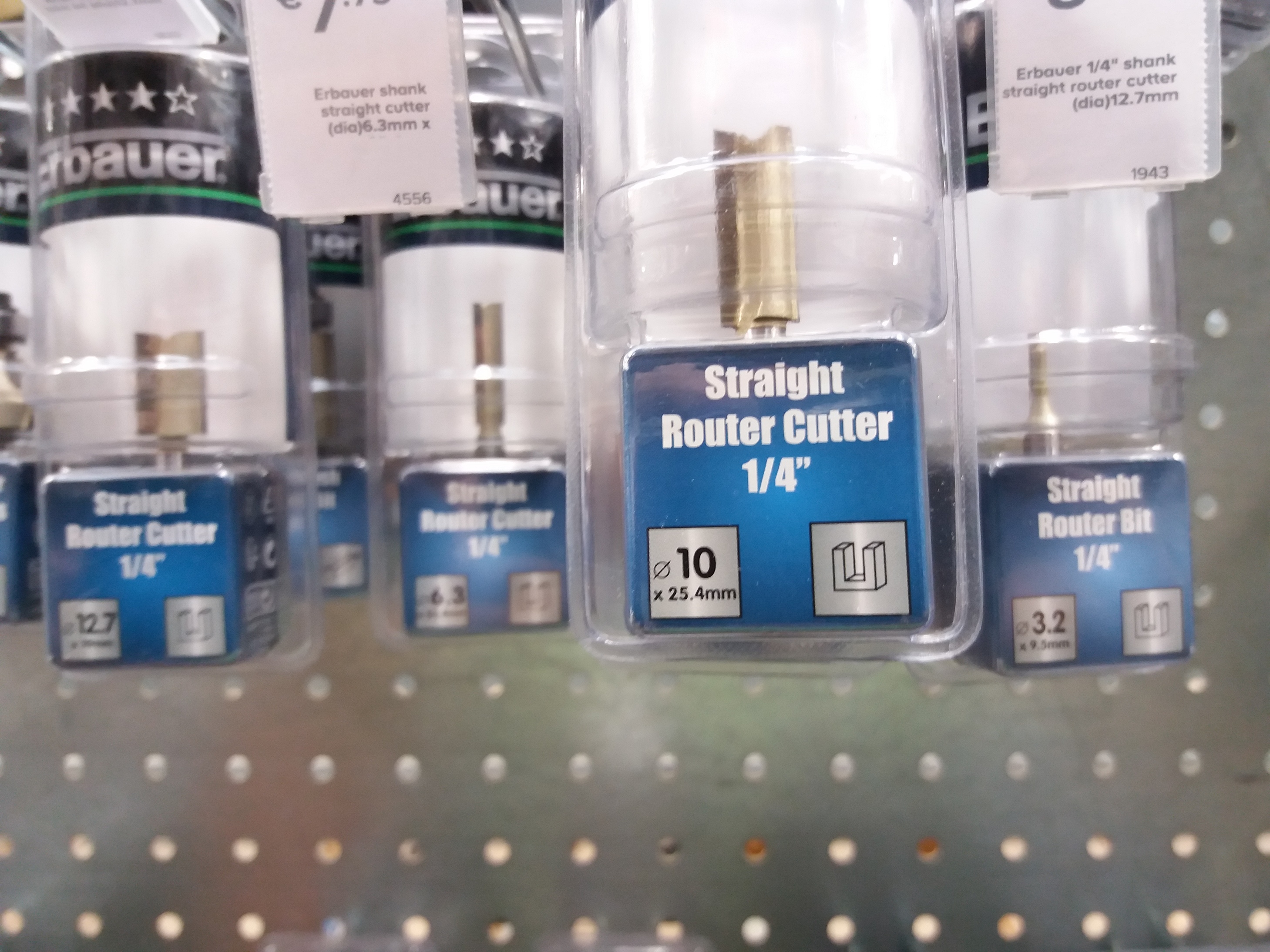

Hi guys,
Would these bits be any use to me for the DeWalt26200
Hi Angus, yes I ordered the precision collet set with the xc.will that do?
Thanks for that Angus. I didn’t realize the .35 would make the difference…I’ll have to check the collet when I get the router. Its a 1/4" router. We got a new range of stock in the place I work and seen these too
I just thought they would be handy to have but as you said that I might hold back and wait till I get the router. Thanks again.
