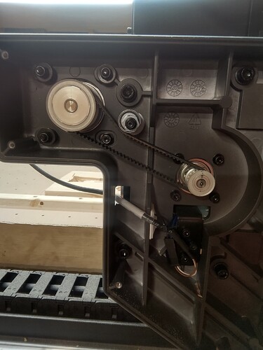

You know what, that noise could also be the belt/pulley slipping teeth… another conversation about this is over in another thread too, you can take off the cover plate and check the belt/motor during this, there is a tensioning pulley in there.
This is what’s under that cover plate: (you might need to turn that tensioning pulley to achieve more tension, but test that stoppage/noise thing again and see if the stepper is locking up, or if the stepper is still spinning and the Ball Screw pulley is stopped…indicating the belt is skipping teeth…)
