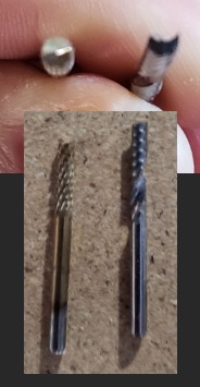

I’m new and slowly learning about CNC. I have watched countless bit videos to learn more about what i need. I bought my CNC used and it came with a bunch of bits, I mostly use 1/8 , 1/16, 1/32 which i think is what everyone else uses most of the time?
I was using the one on the left for most of the time cutting wood, getting good enough results until I tried the bit ont he right, it provided a much smoother finish to the surface it cut out, I’d like to buy more of these bits, in 1/32 which i don’t have, but i have no idea what kind of bit it is, can someone help me?
What is the bit on the left (yellowish) and what is the bit on the right (greyish)
The one on the right is a single flute spiral upcut end mill. The one on the left looks like one of those PCB burr mills. Stop using the one on the left for wood.

That said, I wouldn’t invest much in 1/32"…no one wants to break a $30 tool that only cut three tiny corners.
I’d get a bunch of cheap ones from China.
