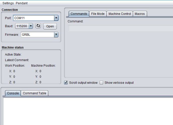

Picked up a new Windows 10 tablet, downloaded Easel - which works great, but am trying to use UGCS (to duplicate the process I used with my Macbook pro) and can’t get it to work. Either it says Comm port busy or it hangs while Grbl is booting. Disabled the Arduino driver and now UGCS at least sees the machine, but like I mentioned, Grbl never boots.

Make sure Easel does not run in same time.
Check to see if COM port is assigned as Device Manager assignment.
Also make sure Baud Rate is 115200 as shown on the picture.

Got it figured out.
In Windows ( different from the Mac) you have to select a different start file for the UGS to load everything ( I think…)
Once I selected the Start file, and selected the correct com port in UGS, it worked.
