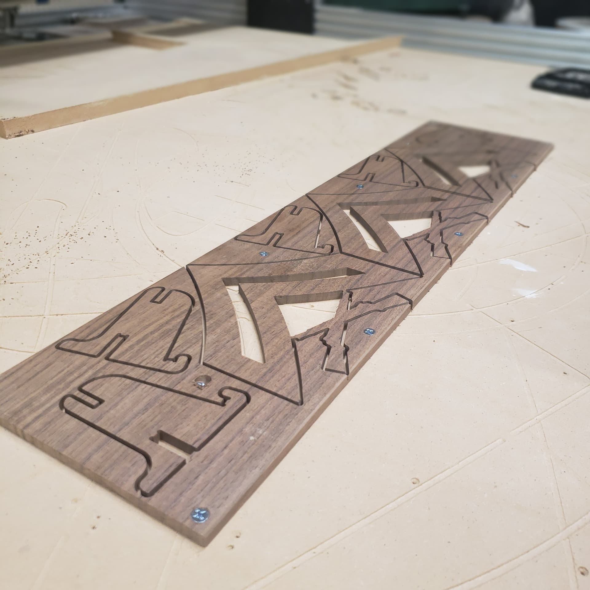

I secure the edges at a safe placement and then ill often incorporate a drill toolpath and run that first, and add screws at those locations before running yhe rest of the carve… even with smaller boards that are prone to breaking. Or of any movements will snap smaller bits… like on this 1/4" walnut.
