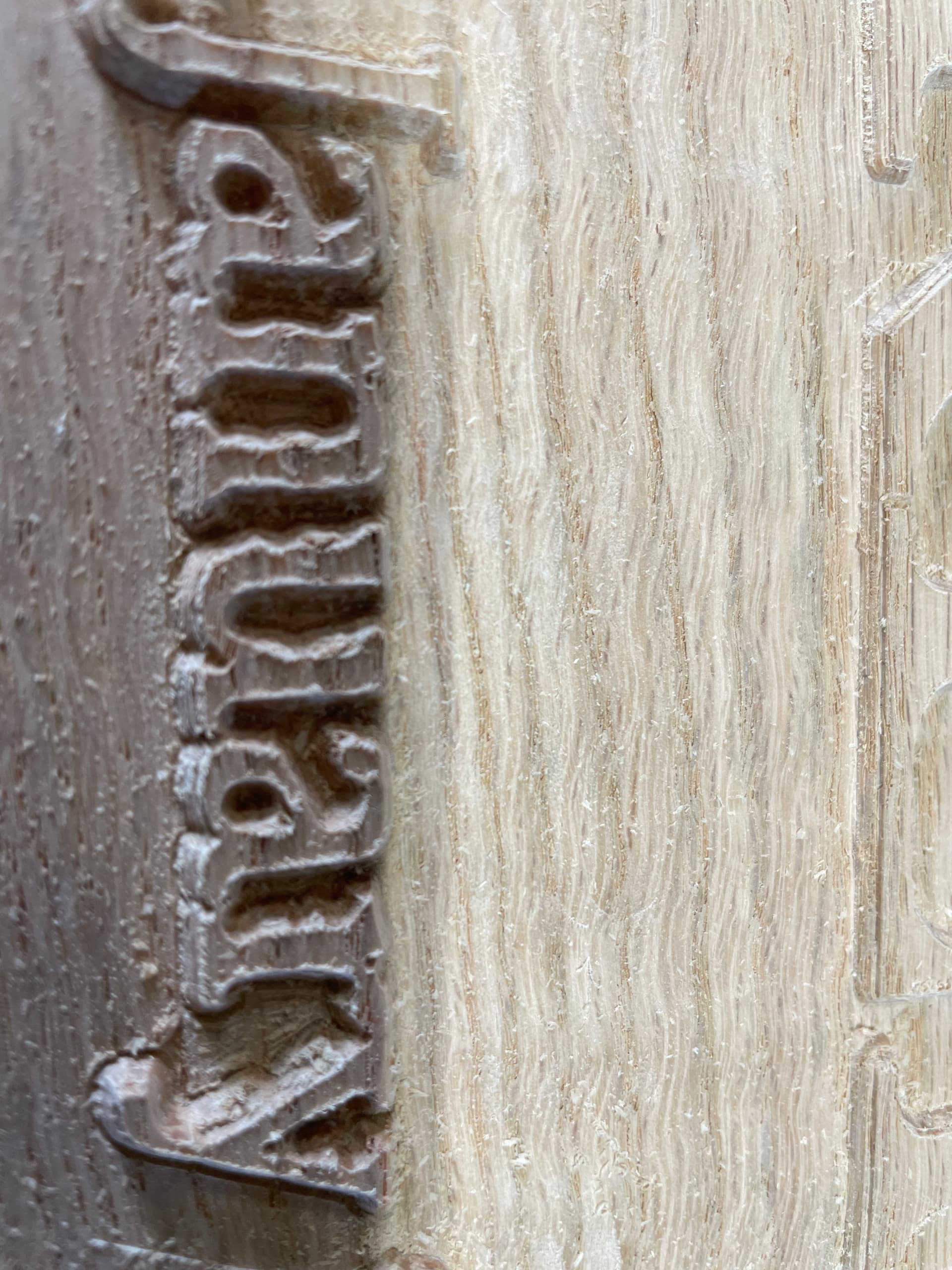

Can you tell me how you rectified this problem. I am having a hell of a time trying to get this adjusted. Lines are wavy. Tightened belts, wheels and now the spindle carriage is loose and wobbles and can not get it to tighten.

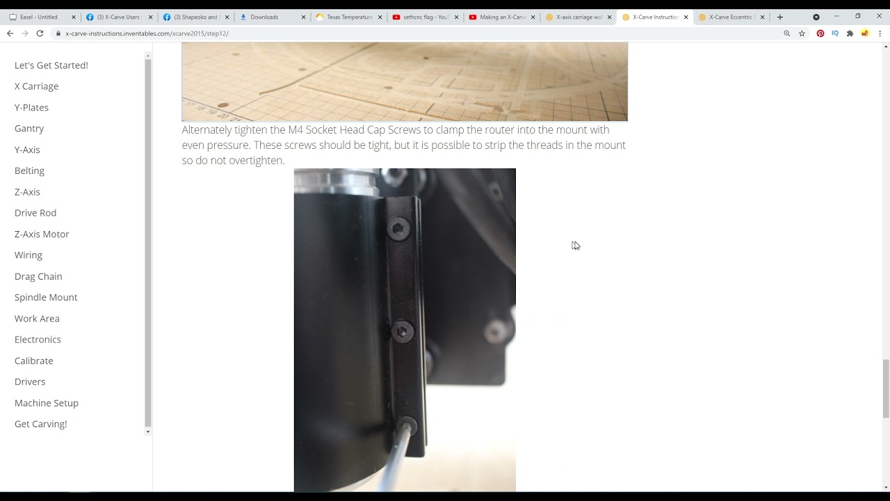

I did notice my router plate is a bit loose on the track, as well and can’t get that thing not to wiggle. I did the z probe and just watched it wiggle as it lowered. I will attach a video of it as well.
In your video it looks like the eccentric nuts were swapped out for a nyloc and washer…
(EDIT: After watching back your video again in HD, I can see that the eccentric nuts are there, but they are not rotated into the tightest direction, so jsut rotate them and that should resolve your issue)
The eccentric nuts can be adjusted to bring the v wheels into the proper location to allow appropriate movement without being too tight or too loose…
