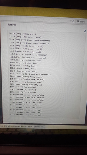

  3. Can you post a screenshot of your machine inspector settings?

3.
It looks like your $100 and $101 settings are a lot higher than what I expect, they should be closer to 40. Have you made any modifications that would require them to be so high? Different pulleys and belts, non-normal stepper motors?
The $100 and $101 are the settings that tell your machine how many “steps” it should take to move each millimeter.
@ColbyHearn - This is what I was suspecting. @RobertA_Rieke is right about the steps if you’re using the stock parts. I would update X and Y to 40 and then follow this calibration video below to calibrate all 3. Robert did a great job laying it out.

Hey changing the values worked! Thanks for all the help guys I really appreciate it! Going to watch that zeroing video now. Thanks again for all the help I was starting to get frustrated with it but and super happy its working now.
