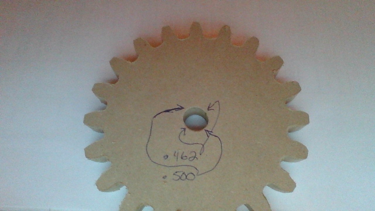

Here is the deal. My x cave is not cutting close to the dimensions in my drawing. Example if i put in a square 2"x2" it will cut it to 1.964"x1.980" or a rectangle i want 1"x5" cut it .964"x4.973". It is consistent on these i have done each one five time and it comes out the same.
I sent 6 hours today checking every v wheels, belts, every nut and bolt, I went in and calibrated( found the video here) the steeps per mm in the X, Y and Z, it did fix the Z problem. The X axis moved 305mm when i told it to move 300mm fixed that. what i find strange is correcting that made no differance in the size of the square and rectangle size I mention above. I do not belive it is mechanical because it is consistent in size. I also tried to cut a square in Easel with the same outcome.

I was thinking maybe your circle problem on the picture caused by Arc tolerances. $11 and $12 for that reason. Junction deviation is how fast you’re taking chips on junctions. I think you know what you’re doing. I’m surprised no one interest this problem on this post. Just give it a little bit time. Or you may call help@inventables.com.
