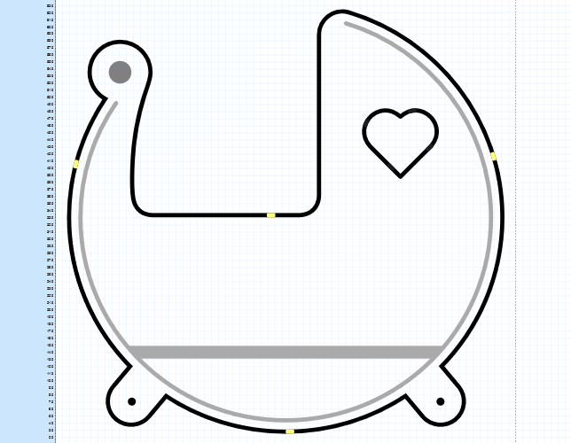

Hi I recently purchased an x carve. I have been using for the last week or so just doing some trialling and testing and trying to find my feet with it. I have noticed that when it is machining a circle or an arc the circle and arc is not smooth every sort of inch or less depending on the diameter there is a small point on the cut face. I hope I have explained this so it makes sense. Sorry I am using an up cut cutter which is a 1/4” diameter bit. My x carve is the 1000mm one with x controller and a DeWalt 611 spindle.

I am using easel but i use auto cad also and this particular project was drawn on auto cad and then imported as a dxf file into easel. I have attache
d a couple of photos of an arc and of a circle which I carved.
this is the link to the project on easel.
thanks for your help I hope the link and photos work ok.

The machine as a whole, any “give” in the system will manifest itself at the tip of the bit.
Having said that, not one machine is 100% rigid. Maximize what you have.
Regarding the “creasing” of the circle, this is due to Xcarve dont support arc commands, it split a larger radius into smaller straight sections.
What governs the length of this straight line is defined OR/AND in CAM / GRBL parameter.
For instance, in Fusion360, roughing operations have a coarser arc tolerance than finish operations.
If you zoom in on the circle in Easel you can see the points. If you were to create a circle in Easel it would cut smooth.

I thought that it might have been because I imported it. So I did just a circle on easel and the circle was elongated very slightly. But I think this might be down to what Haldor had mentioned in his previous message about a lack of rigidity . I will have a look at stabilising the machine and reducing the amount I plunge at a time and see if that helps. Can I do something on cad to stop the segmented arcs and circles or is there another program available to connect the x carve to .

Give this a try, I set it up in Corel, saved it as an SVG then imported it into Easel.
The circle wasn’t round so that was one of the problems that you were having.

sound like your belts are lose.plywood is a grabbie wood, the plys are headed in several directions. reduce your speed,rate of cut depth and use a smailer bit. if this doen’t work write back.
Thanks Michael I will give it a try I will tension the belts a bit more I was hesitant to tighten the belts too much when i was putting the machine together.

Use a scale and aim for about 3,5lbs of force to lift the belt 1" upwards at the middle.
