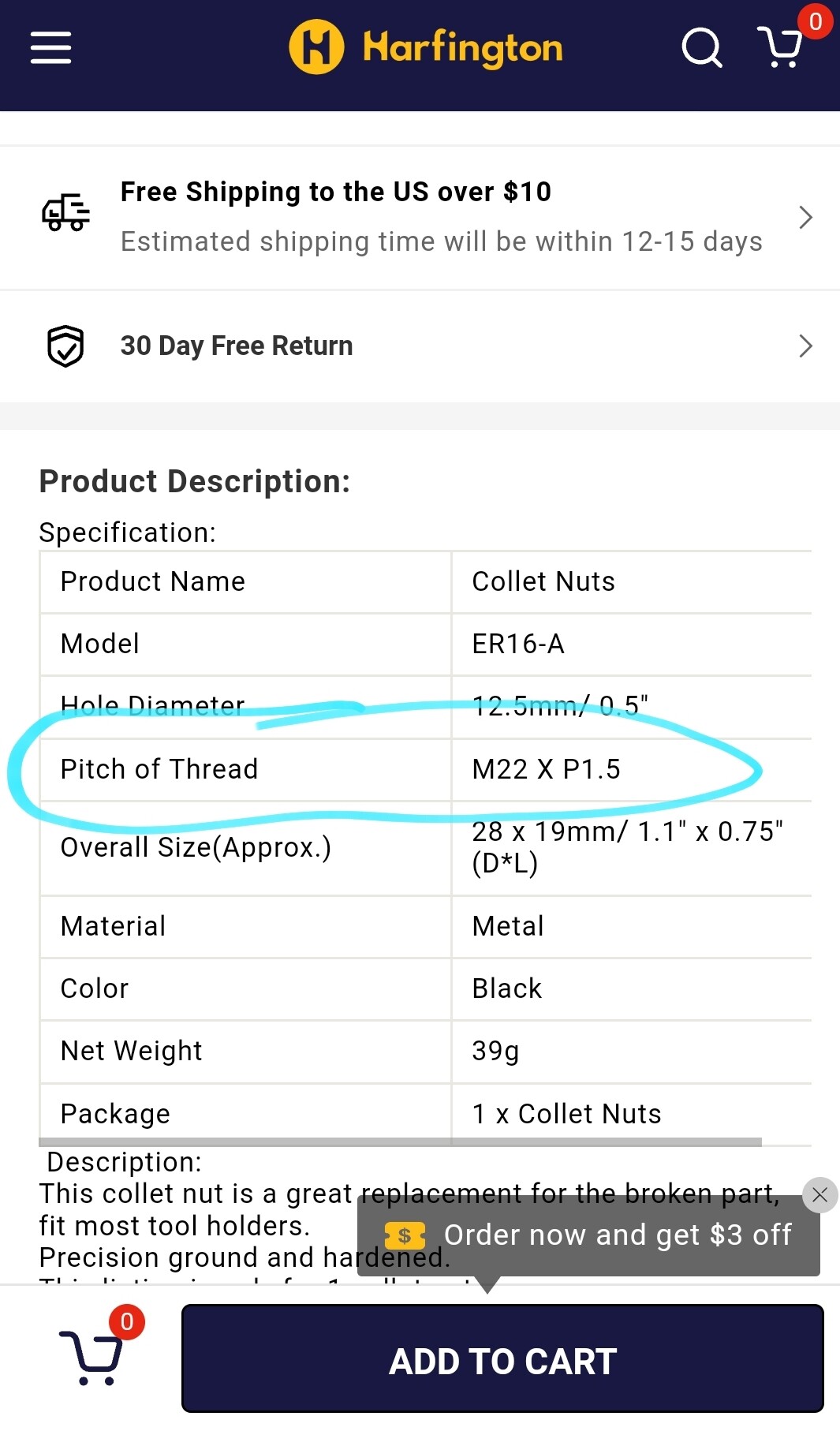

To my disappointment, my XCP only came with one collet nut, seems silly to keep swapping my collets back and forth, so naturally I went online to the shop here and cannot seem to find the ER16-A collet nut for the XCP.
So then I went over to ToolsToday.com and found it! However when I received the ER16-A collet nut, I quickly realized it’s twice the diameter and does not fit on the XCP.
So do not order the 28mm one from ToolsToday.
Anyone have this same thought, but find the solution? Would love to order a second one in order to streamline bit size changes.
This listing has multiple collet nuts in one listing, when you select m22x1.5 thread it changes to the ER16A collet size. This is the correct size and thread for the XCP
@SethCNC yeah, i bought the first one off Amazon, and surprise surprise it’s twice the size as well. Now I have six nuts to return and hopefully get my money back on.
But i’m holding the nut that i use on my X-Carve Pro in my hand and it’s labeled ER16-A.
I only own one CNC, and it’s the one I’m referring to though.
The other two I purchased, are also labeled ER16-A. However, the XCP one is 15/16" in diameter and the other two are 1.25" in diameter. I measured them with a digital caliper.
@ForEverSkateStuff Use those digital calipers on your spindle threads. My guess is they’re about 19mm?
The threads are different in your collets. I’ve seen er16 collet nuts with M19 1.0 threads (looks like the XCP) in addition to the standard M22 1.5 threads.
You have to check the thread specification, and you have to trust the sellers published information (tools today - probably, Amazon - maybe).

Inventables reached out to me, they are aware of it. It’s why the ones they have listed in their store now explicitly clarify that they do not work with XCP regardless of the ER16A label. I’m just waiting patiently for them to provide some for sale.
See, this is the size that My (non-XCP) uses… so it sounds like Some XCP’s shipped with m19x1 threaded spindles and others shipped with M22x1.5 threaded…
For the M19x1 most of the Amazon listings for Er16-A are the right ones…
The Edited Link I provided above is for the M22 Threads.
The choice is yours, to make, but looks like the M19 us the correct for yours and the M22 is the correct for ForEverSkateStuff
But I would still contact Inventables Support and get clarification as to whether they have mixed batches and what’s going on with all that…
