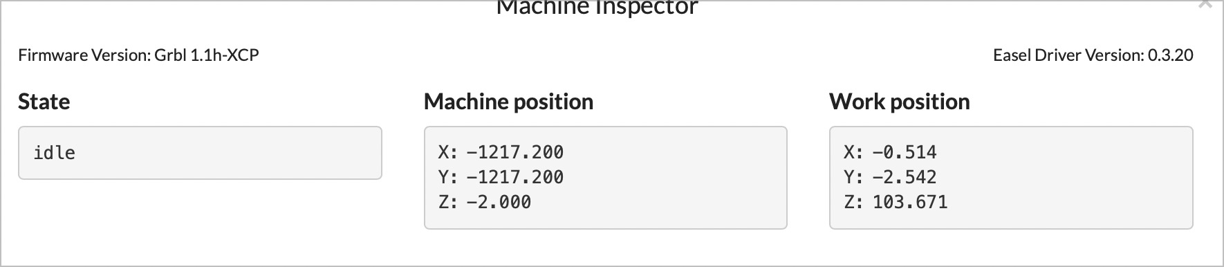

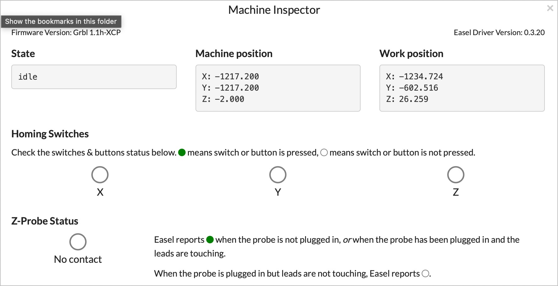

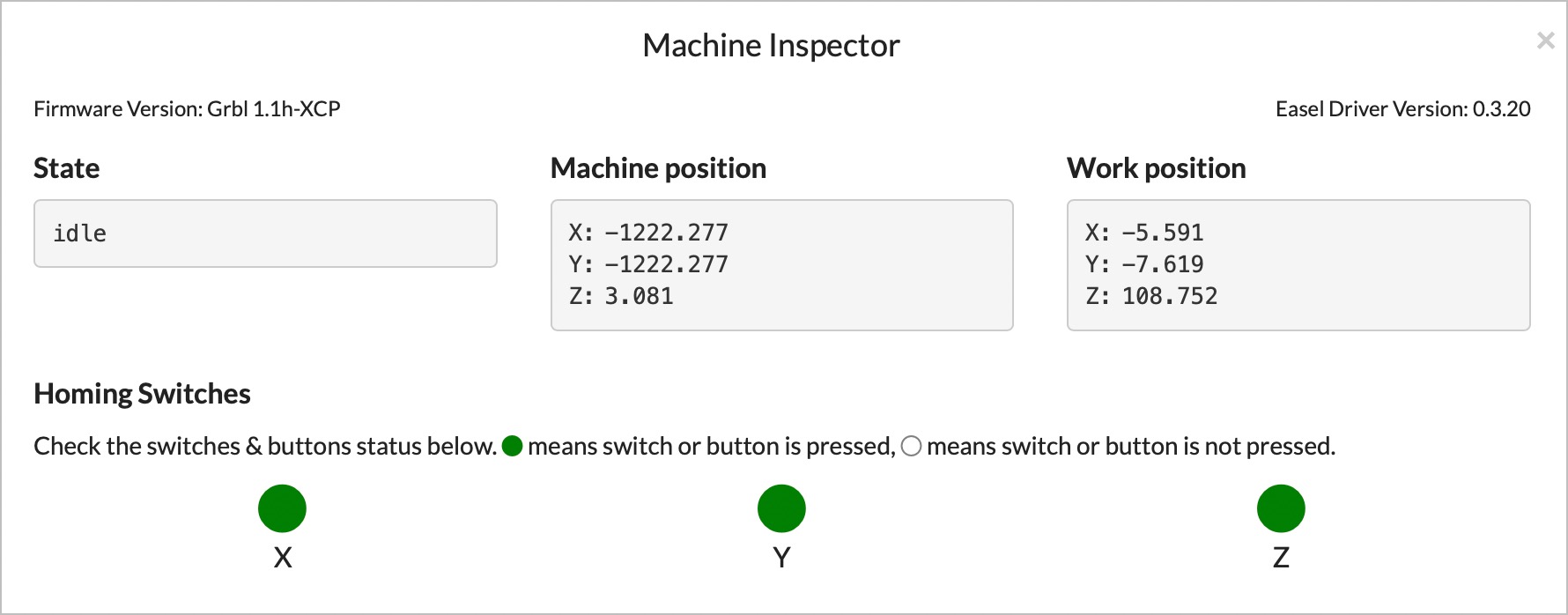

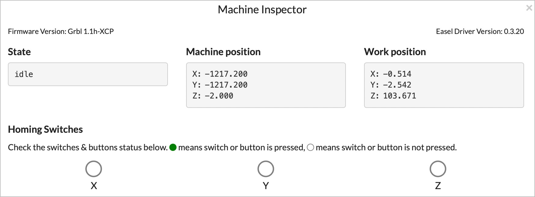

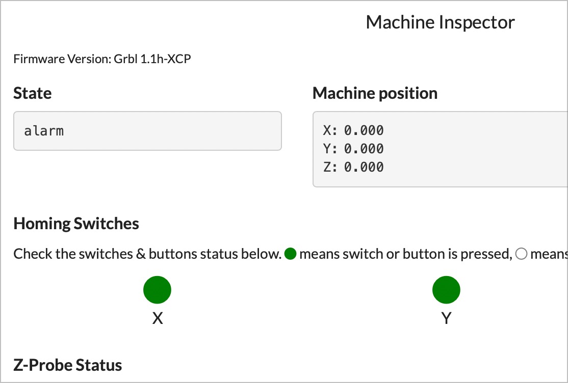

I do not believe that my X-Carve Pro 4x4 is homing properly. These numbers in the following screenshot do not seem correct to me. I have researched this extensively and have come to the conclusion (right or wrong) that my XY zero points are set correctly at 1219.200 as verified in Machine Inspector. When I home the machine, none of the homing switches light up. I have to manually jog the machine left, forward, and up to activate the switches. I have verified that my Y1/Y2, X, Z cables are plugged in properly.
Does anyone have any suggestion on how to recalibrate or solve this issue?
I have also been told by Inventables tech support they should be correct.

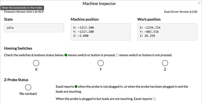

As seen in this screenshot my home position is not 0, 0, 0 as I would expect. Tech support also told me that these numbers are correct. Just curious if the community also agrees that they are correct.

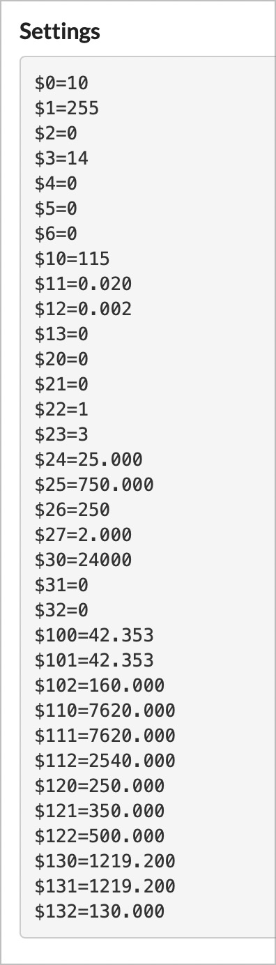

grbl looks good, I was afraid that the one for homing might have been turned off.
Well after homing it should read 2,2,-2 (backed off 2mm from each zero location (z is negative for plunge direction) this is defined by $27 setting) So that value looks like it’s homing to the incorrect direction for X,Y as if homing is inverted. (-1219.2 - 2mm= -1217.2)
It does home to the front left corner, correct?
If Yes to #1, then when you wired up the machine did it operate in the correct direction? Or was re-wiring necessary to make it move in the correct directions?
IT really looks to me like the machine was in the front left when you powered on, then it homed to the rear right, and then you manually jogged it to the front left again… or something weird like that having to do with homing the wrong direction or moving in the opposite directions…
The other possibility is that something is wrong in the firmware on the cnc and it’s not zeroing the home out as it should be…
EDIT: One more thing, when you do try to home, what is the Alarm/error number showing? you first screenshot showed Alarm status. Is it alarm #9?
IF It is Alarm 9, then it makes more sense… and your machine has moved MORE than the allowed distances (1217.2mm) in both X and Y without triggering the limit switch)
Most Likely, either they are out of place and not being pressed, or they are defective, or defective wiring (press by hand and see if that screen turns green if it doesn’t then ?)

1. Yes, front left corner.
2. Yes, correct direction. No re-wiring necessary.
It has been about three weeks since setup. I do think it was front left when powered up the first time. I do not recall if it homed to the rear first. It seemed ok to me but I was a complete newb then and now. I have learned a lot the last few weeks but have a long ways to go.
I will have to try to recreate the alarm as I have not seen/noticed it since changing $1=0 to $1=255.
I also think it is moving to far as it seems to growl a little louder than I think it should.
I have tried to recreate the alarm and so far I cannot.
Ok, i think you’ve confirmed enough to indicate that in most likelihood the config.h (home config) is not setup to zero out after homing. (Likely it was corrupt when initially loaded) What would need to be done is flash a fresh version of the grbl V1.1h to the cnc controller. which requires using the Arduino IDE software.

The values reported are correct, Easel is just displaying what we request from GRBL. If you’re still having issues with your homing, please reach out to help@inventables.com for more support.
