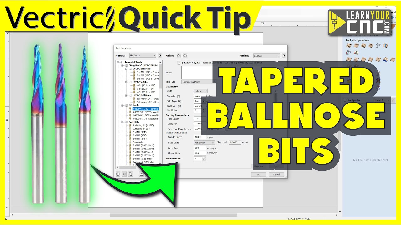

Can I ask what settings did you use when adding the .1 tapered ball nose? I don’t see an option for that bit type when adding a custom bit. Thanks
The OP is using vectric, i assume youre also using vectric…
This is how you enter tapered ball bits into vectric tool database.
