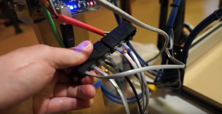

Be careful tying two outputs together. With the appropriate design it can work, but if you don’t have a good design then one output goes high and the other goes low you can get a short circuit from power to ground which can fry the switch/port, and maybe the power supply.

This video also shows switches/sensors on both sides of each axis like I plan on doing. However I am unfamiliar with the TinyG Controller snd its connections and I could not verify how these where wired to it with his circuit boards. Wether each sensor has its own input or if they were ran in parallel
