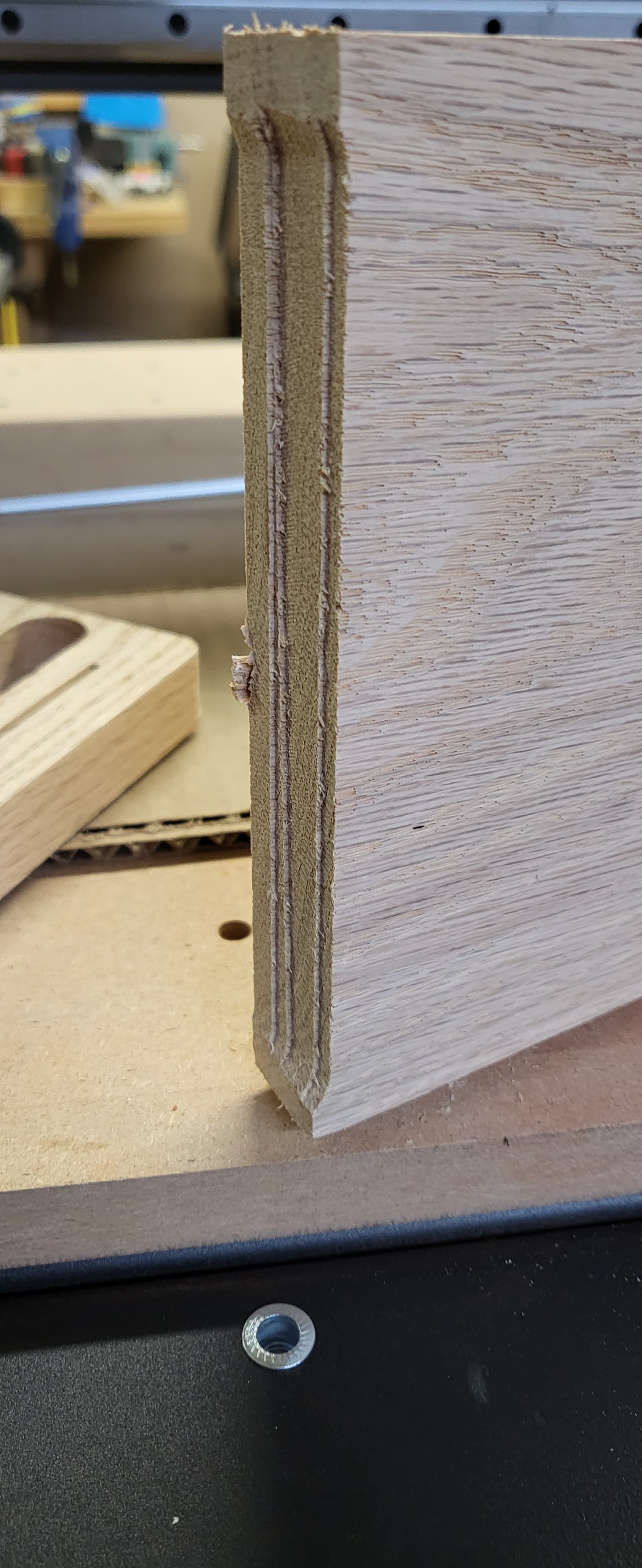

I was running an 1/8" down cut bit in oak at 180 in/ min @ 18000 rpm to get the chip load of 0.004 based on Amana’s specs. Just doing a cut out using a conventional cutting strategy when I noticed it started slipping gong against the grain.
I had similar issues on earlier cuts and retensioned the x-axis belt after talking with customer support. I also slowed down to about half the feed rate to keep the issue from happening again, but thought I’d try and give things another try, but had the same issues.
Added some photos of the failed cut below.
For those who are experiencing belt slippage, check your tensioner.
I initially had issues with slippage, but then tensioned the belts per this picture, and haven’t had an issue since:
That was the solution that customer support provided me, but it seems it still happens at high feed rates on my system. It would be nice to run at 140+ inches per minute but I guess that is not the case.

@GregBuckwalter use the angle of the eccentric nut to determine the correct tension. It should be between 60 and 90 degrees if I remember correctly.
I’m running below 100 in/min to minimize the slipping and just reduce the rpm to get the correct chip load. As I understand chip load is the most important thing to match to keep the life of your bits as long as possible.
@JimLavin Inventables customer support recommends 90 degrees
