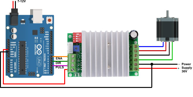

Perhaps you might build your own control replacement using low cost components. Result is low initial cost, replaceable components, customizable as you need.
Technically speaking a shield is not required.
A good shield is however conveniant.
I would advice you to source individual drivers (TB6600 being very cheap and powerful to name one) so if one driver goes belly-up its quick and easy to replace.
Minimum requirement:
TB6600A - Layout04
