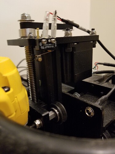

Z axis is sticking
It seems the v wheels are slightly loose but everytime the z axis tries to move, I feel the piece that goes around the threaded rod is just way too tight. The stepper is spinning and the thing just wont move.

So everything spins. Just wont move.
Correction. The rod is not spinning. It gets stuck on the rubber thing.

Sounds like the set screws are lose on the pulley on the top of the rod.
this? That as right as possible

It was the 2 tiny screws… I tightened them again. It works now. It’s hard to tighten those with a eyeglass driver. -__-

We joke a lot about blue locktite on the forum, but it will keep those screws from getting loose. Blue locktite 242 works well on the pulley screws.
Yeah… only issue now is the bit sometimes doesn’t raise enough and causes this
I tried to sand it down but it’s too deep
You are experiencing lost steps for some reason. If the pulley you have tightened earlier isnt seated properly is can cause slight slippage, causing the Z to not retract to intended height, in effect carving lower and lower.
Another possible reason could be that the delrin block (black plastic) that goes around the srew is tightened to hard to the carriage. It should only be firm, not tight.
A third possible reason could be poor contact on one of the four stepper wires.
