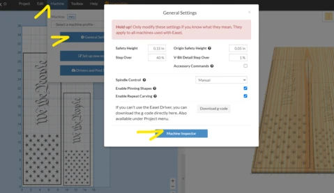

it looks like stepper motor internal lock caused by max speed or acceleration being set too high… What are your grbl settings?
you can read them at the bottom of machine inspector:

If I’m reading this correctly, and there’s a good chance that I’m not, then the Z stepper’s max rate and acceleration are both lower than those of the X and Y steppers.
$100=40.000 (x, step/mm)
$101=40.000 (y, step/mm)
$102=320.000 (z, step/mm)
$110=8000.000 (x max rate, mm/min)
$111=8000.000 (y max rate, mm/min)
$112=500.000 (z max rate, mm/min)
$120=500.000 (x accel, mm/sec^2)
$121=500.000 (y accel, mm/sec^2)
$122=50.000 (z accel, mm/sec^2)
$130=750.000 (x max travel, mm)
$131=750.000 (y max travel, mm)
$132=100.000 (z max travel, mm)
