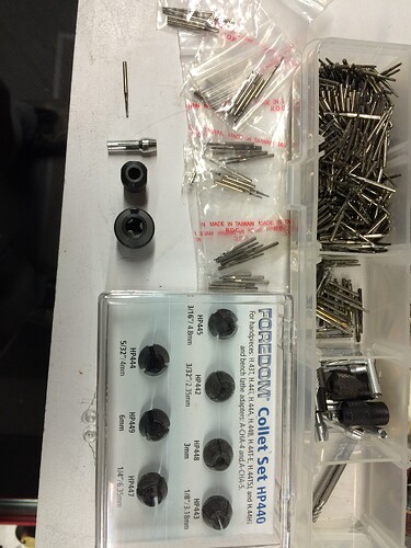

Is anyone aware of a 1/16" collet that will fit the Dewalt 611?
My Dentist gives me his used cutting burrs by the handful, ultimately i have an endless supply from my dentist when I need them. these burrs worked great chucked into my dremels and Foredom handpieces. I would also like to use these on my 611 if at all possible. The amount of savings would be phenomenal. Considering i just lost $20 when an end mill snapped, these little guys are free to me and if i break one, then so what just throw it away and grab another.

Top photo 1/8" carbide downcut bit from Stew Mac is the top bit. Below it is the 1/16" dental burr.
The bottom pic shows the collet selection for my Foredom which is interchangeable on my dremels. Would be nice to have a collection of collets similar to this. I have the Precise bits collet but currently they do not offer this collet. I have contacted them to see if it would be possible to have one made.
As you can see my collection of cutters is large. I just went to the dentist this past week and did not even ask for more. I have given away about half of what I still have as well to other carvers who have started hitting their dentists up for them as well.

Bill, i do not have anything that fits my dremel or my Foredom that will match up to my Precise bits collet set, which includes the 1/8", 3/16", and 1/4" collets.
the only Collar per say that i have that is not associated with dremel or Foredom is a 1/4"-1/8" adapter. nothing that i have allows the 611 to use a 1/16" shaft cutter
I have a 1/16" collet for the foredom, several for the dremel and an adjustable drill chuck for the dremel, but none of these will work with my current selection of collets for the 611

As of now I have seen some sleeve adapters. If Elaire will not be able to provide a 1/16" collet, the sleeve is what I will try.
Check out Foredom web site they have a 1/8 to 1/16 collet adapter part # HPL4-3234 $16.30 THIS WILL CONVER A 1/8 COLLET TO 1/16 TH

it looks as if the collet adapter from 1/8 to1/16" will be the route that i have to take to be able to use 1/16" shaft cutters.

my question is though what collet will that collet adapter work with? because the dewalt router only gets supplied with a 1/4" collet and i also bought the precision bits 1/8" collet so will it work with the precision bits collet? or another 1/8" collet?
This “Collet Adapter” should fit into any 1/8" collet to reduce it to 1/16".
It should not matter if you have a stock 1/8" collet (which they don’t make for dwp611), an Elaire 1/8" collet or the 1/8" precise bits collet. This adapter should be universal for most 1/8" collets.
So Yes this should fit the 1/8" precise bits collar and most likely most other 1/8" collets on the market.
