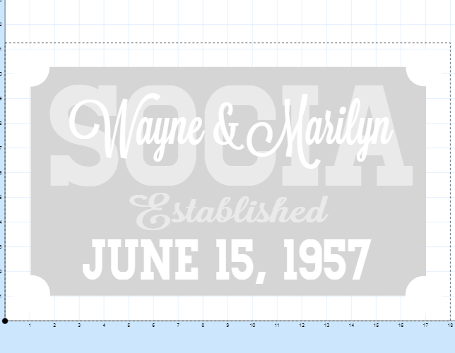

2 stage carve producing lines around letters
If you look closely at the picture below, you will notice that Easel created a “gutter” around the letters in this carve. This was a 2 stage carve using .25 endmill for the roughing and .0625 endmill for the finish. If the depth for the finish was off, I would expect the whole finish to be deeper. This was not the case. only the final pass around the letters is deeper.
Has anyone else had this issue?

Did you redo the Z zero after changing bits?
Yes. I use the Triquetra P3 every time I change bits.
Is the extra depth the same around all letters? It appears variable.
If not I suspect the board warped during the carve or between stages.
On closer inspection, that appears like the smaller bit cut into what was previously carved and left a sliver of uncarved material.
This could be due to the larger roughing bit not cutting the same diameter as programmed or a slightly off X/Y zero.
I’ve had both happen to me.
A close up of one of the areas could shed more light on it…hard to see while zooming in and the angle is only showing one way.
I will get a better picture tonight and post it.

Here are two up close pictures of part of the carve. Notice how on the last pass right next to the raised letters, a lower area or gutter was carved. It did the around pretty much all the letters.

Thanks Phil. I actually just removed the original picture because it had an oops when I re-zeroed for the finishing pass. The close up pictures was a second carve that I did with everything (both the rough and finish zero) properly.
The pic that I removed looked like I was losing Y steps but the machine is calibrated good (just did the step calibration a couple of weeks ago). Both x and y are dead on.
