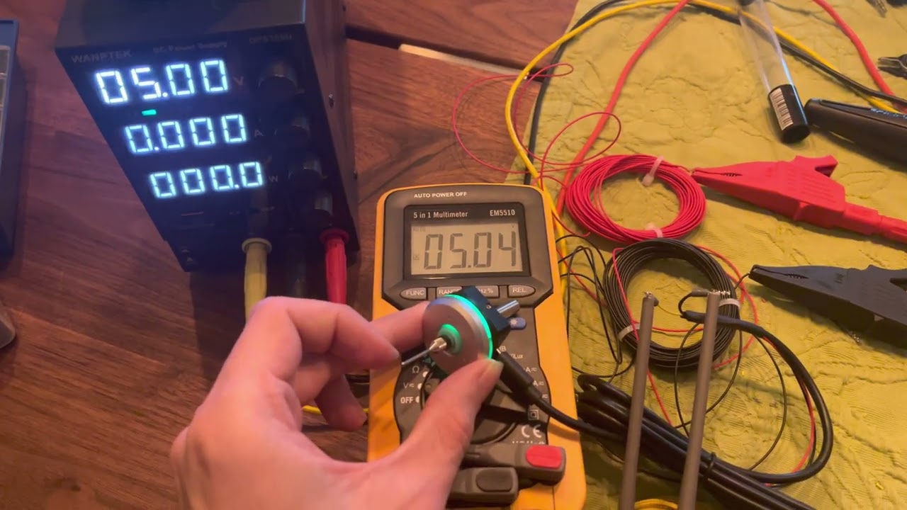

Hmm… So the 3D Touch Probe has arrived and I mocked it up between a Benchtop PSU set to 5V and a Multimeter standing in as the X-Controller to see how things operate…
A short Video of it:
Thing of note is the Voltage coming out of the Probe is the one that goes into it… 5V in was 5V out, 7V in was 7V out, etc…
Obviously, something ain’t right as the Normally Open Model I’ve ordered to mimic the behaviour of a Tool touching off a Touch Plate is inverted - The Signal flows until the Probe makes contact ( NC ) instead of vice versa ( NO ) - Did they send me the wrong one or is MY Noggin’ logic inverted?

Your sensor is NPN-NO as shown in the only info provided.
The NPN (transistor type used in sensor) part means that it is “active low”. The NO part means it will only go low (connect to ground), when triggered.
You don’t want to invert the signal.

Without the relay, when you trigger the probe, what do you get on the signal line?
I’m assuming the X-Controller caring less about the Voltage ( for as long as it’s not overloading it ) than if or not a Current is flowing between Probe and GND Terminals on its back.
That would be in the first Video - The Voltage drops from the 5V set by the Benchtop PSU down to like 17mV:

Basic principle of how the inputs work:
All that matters is the voltage on the probe INPUT pin. Like I said, by default, it is high (5V, logic level LOW, digital 1) due to a pull-up resistor holding it loosely to +5V. When you touch the grounded endmill, to the Z-Probe plate, you are connecting that INPUT to Ground, bringing it low (0V, logic level LOW, digital value 0). That LOW state is interpreted by the controller as a triggered probe event.
Your new probe:
The 3D probe you have is an NPN-NO sensor. That means it has internal circuitry that will output a logic level LOW (0V) when triggered. I could guess at a simplified version of the internal circuit, but you already measured and observed this. You could take that signal line straight from your probe to the probe INPUT on the controller and it will work (as long as you tie grounds together to establish the common potential reference). But, you chose to run that signal through a relay.
Your Relay:
The relay you have is an active LOW mechanical relay. That means that when the signal INPUT is brought LOW (0V) it will close. You are taking the LOW level from your probe to switch the relay. When it closes, you are connecting your X-Controller probe INPUT to ground. This is the same as touching the grounded endmill to your Z probe plate. This is completely unnecessary, however, as you are taking a LOW output from your probe to bring the input on the relay to LOW which then closes the relay connecting Ground and the X-controller probe INPUT, which brings the probe input LOW meaning the probe is triggered. No inverting of any signal is happening (except maybe inside the 3D probe, but let’s not complicate this).

Normally Open (NO) means exactly what you think…the natural state of the circuit/component is open. But we don’t think about these things in terms of current flow. Again, the ONLY thing that is relevant in this topic is the voltage of on the Probe input. The Z-Probe and your 3D probe have the exact same working principle…when the probe is triggered, the Probe input voltage goes LOW.
The NPN part is just because it is an active sensor that uses transistors or the equivalent to control the signal output. An NPN sensor means that we are switching the Ground side of the circuit, so a triggered event results in a signal voltage of 0V (LOW). We can simplify this to a circuit with a NO switch.
Notice the output is HIGH (+5V) even though the circuit is open.
If our probe (Z or 3D) makes contact (triggered), it’s the same as closing that switch.
Now, our output signal is 0V (LOW), and the probe event is received by the controller.
Your relay isn’t doing anything (other than slowing down the switching speed, and making fun clicks). You are using a LOW signal to activate the relay to output a LOW signal. Try without the relay.
