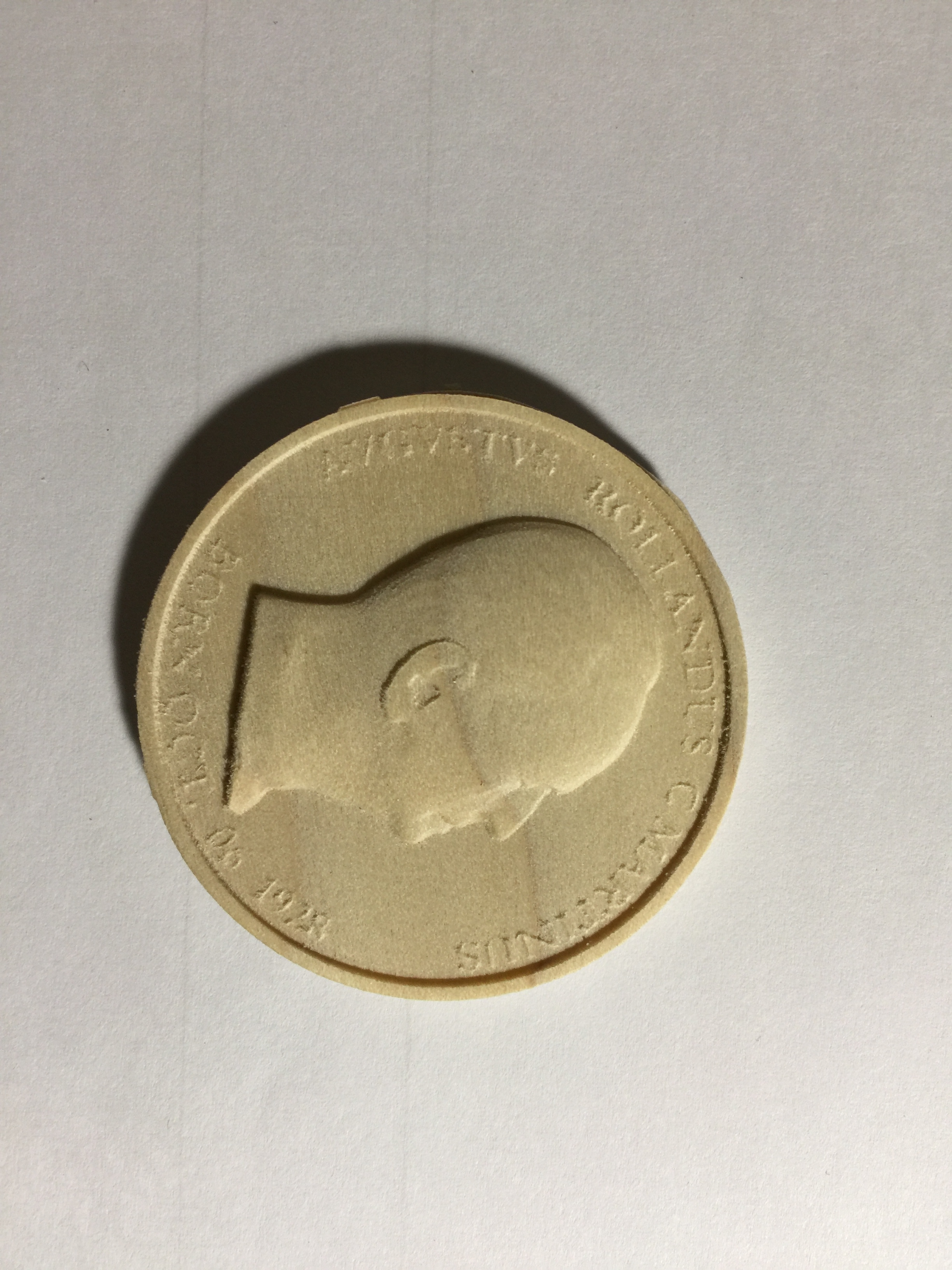

When you are ready to create the toolpath just use the 3d Rouging toolpath with a 1/4 inch ballnose and then run the 3D detail toolpath with a small ballnose tapered tool. I use a .5mm tapered ballnose with a stepover of 10%. The smaller the stepover the smoother the final product will be and the less sanding it will need. But be sure to check the estimated time, since a small stepover can cause very long carve times. So you will need to find a suitable compromise between carve time and smoothness.
It also helps to reduce carve time if you create a bounding vector around the 3D shape and then have the rouging and details passes cut within the bounding vector.
