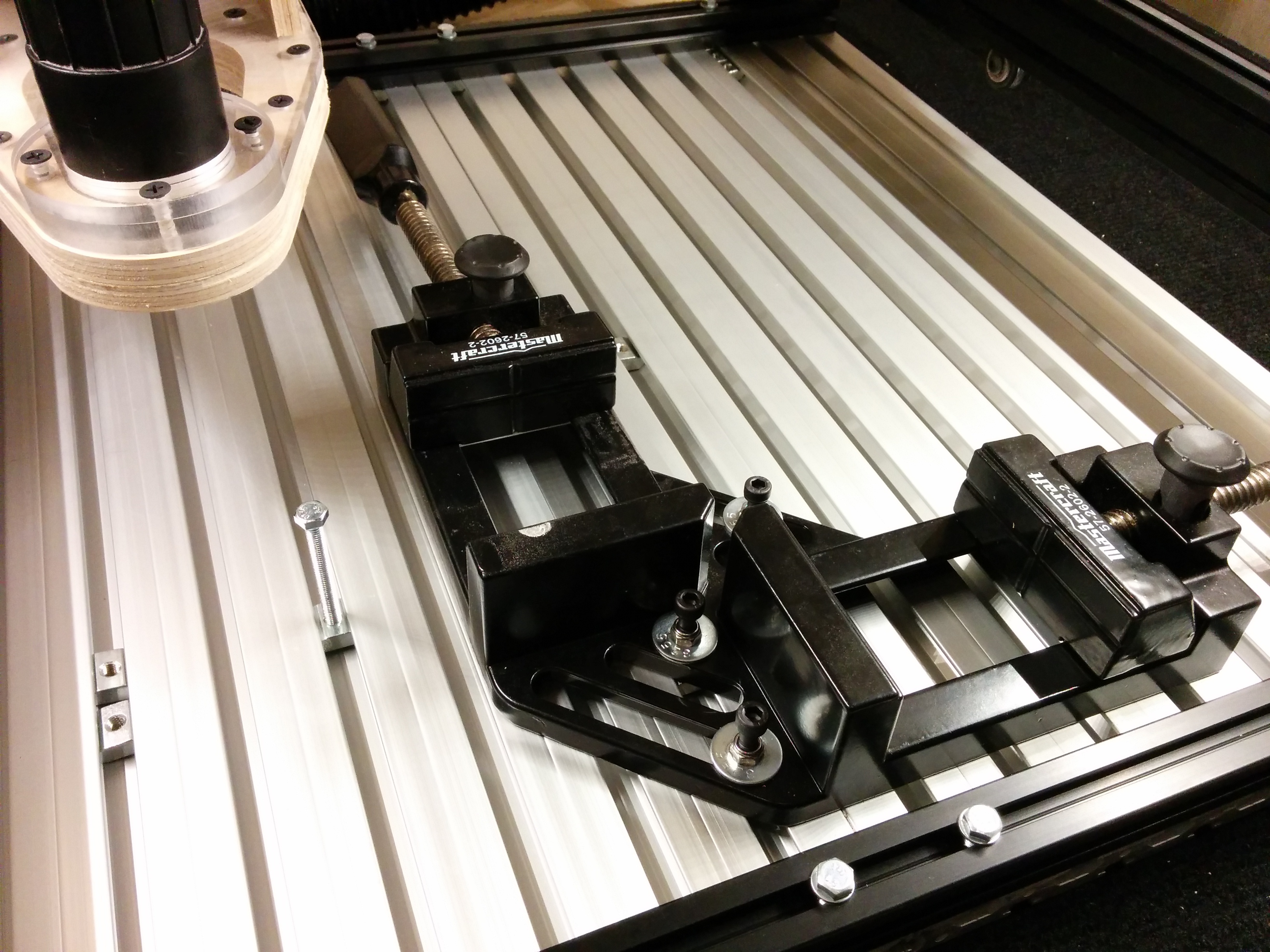

So I had a go at flip milling for the first time, a bit ambitious to start with 4 sided, but it worked pretty good.
Im using one of those corner vises which is pretty low profile and a M5 bolt as my index.

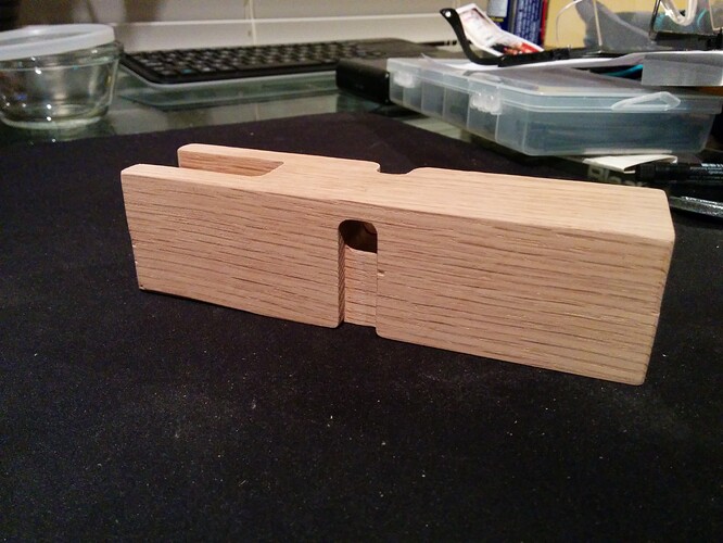

As you can see in the pictures there’s about 0.1mm alignment error, which for this type of fixturing im quite happy with.

awesome! What is it?
Its a night stand for an iphone, a watch and some ear-rings.
awesome, kind of figured the iphone part, was curious about the others.
