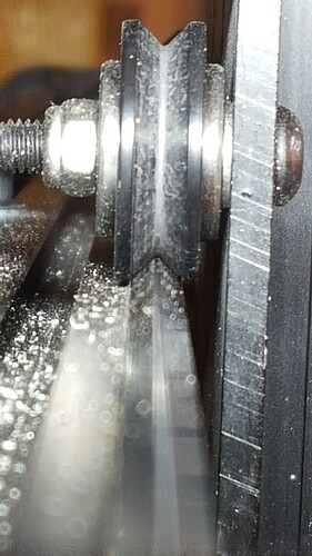

Here are photos showing the v-wheels after this mod. I am not seeing the .022" v-wheel misalignment (riding up) predicted by the CAD. I guess we’d need a tolerance stack-up analysis to really understand the situation. I did clamp the maker-slides against the spacer bolts while tightening their nuts, which helped the carriage roll smoothly.
Or it could be the fact that gantry plates have some adjustment for tap screws to travel a bit horizontally.
After you told me about the issue “I might have” I tried to find any gap between wheels and rail after even loosening up all the wheels and I could not find any.
Is this with the 3/16 bar through the middle or your original 30min mod? I think Phil is talking about the bar through the middle approach. I experimented with putting the 3/16 bar in, but noticed it was not traveling as easily due to the alignment issue. I ended up taking your 30 min mod idea and adding bars to clamp down on the top and bottom (aka 60min mod). That resulted in a super stiff bar with minimal work, no change to spacing, and best no modification to the maker slides. I highly recommend at least trying that mod first before committing to drilling the maker slide for the bar though the middle approach. I suspect the clamp method is just as stiff if not more so.
Hi @Petesworld - The photos are of the mod described at the beginning of this thread, I guess we refer to it now as the “30-minute mod”. The CAD predicts that the v-wheels will be pushed apart if M5 bolts are used. But I’m not seeing any evidence of that, looking at my real world X-Carve after the mod.
I really like the idea of using bars (rather than washers) on top and bottom of the x-axis makerslide-pair. I want to try that soon!
