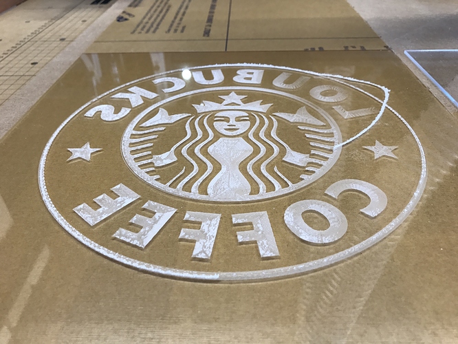

As some of you know I had some issues with the squareness of my bit (covered in another post) so I took some time out to fix that issue before engraving the cast acrylic piece.
Then I went through the process of creating a sacrificial waste board which I surfaced with a 0.5" bit to get it as flat as possible.
Not too shabby. I even installed some side shields to help with stray chips.
Then I got it all set up to cut the cast acrylic.
Please don’t tell my wife I used her weights. =)
Then, I went and cut the acrylic. Not happy with the result. The acrylic wasn’t flat enough so it didn’t fully cut. =(. I’ll work on leveling everything out better. I’m not sure how to get it any flatter though.
I’ll post pics of the results when I get a chance.
Oh, BTW, I’m still going to try and save the acrylic piece I’m having issues with. I’m creating a clean up file in Easel as we speak.

So, yeah, the acrylic engraving didn’t work out. In trying to reach the depth of the parts that didn’t carve the first and second time the third time was not a charm. =). Ended up gouging and heading off track. Oh well. Just another thing to figure out.
For now, just for time sake, I’ll just make little feet for the sign so it can be put into service on Lou’s desk next week. In the meantime I’ll keep trying to get the acrylic etching technique mastered.
