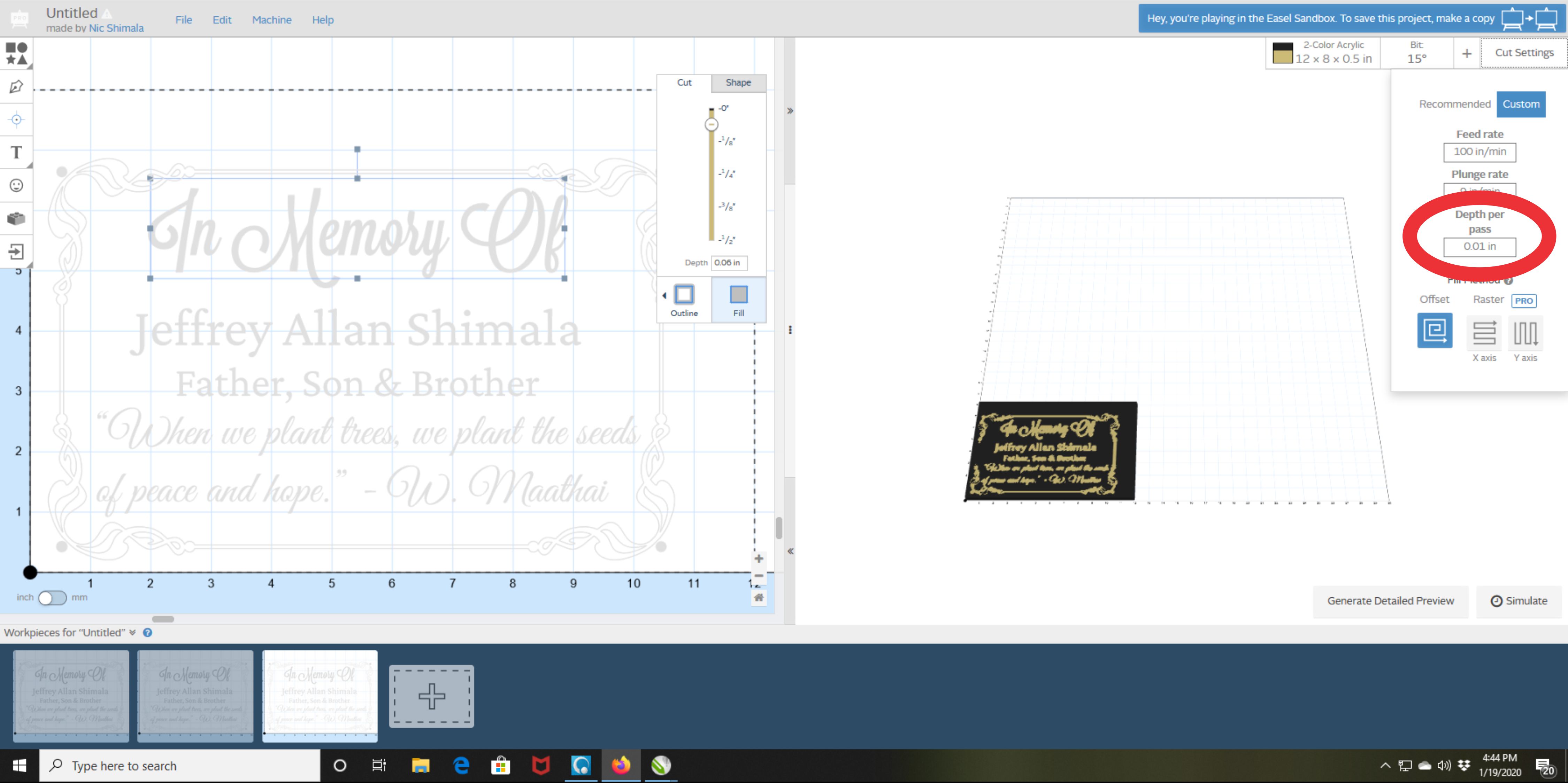

I did some searching and didn’t find too much on this. I want to make a plaque for my brother. I haven’t done two-tone acrylic before and want it to look good. With the fine lines I have chosen, it looked like my 15 degree bit would give the best results. Is there any suggestion on cut settings, final cut depth, etc? This will be outside by a tree we’re planting, so is acrylic even the way to go? Right now, it has the cut settings (feed rate-100 in/min, plunge rate-9 in/min, depth per pass-.01 in), it shows a 9+ hour carve. Not sure what I can change or if I have way off settings. All cuts are .06" final depth.

I do understand how it works, but that seemed like too long of a carve. And I would be using the black on gold two tone acrylic from inventables
9hrs for that seems excessive.
.01" Depth per pass on a .06" deep carve = a lot of path lines especially on the larger letters.
You might be able to go full depth in one pass on all the finer lettering? Or use a slightly wider angle bit to achieve that?
i can chnage the depth per pass, but it wouldn’t knock off too much time. i’ve tried a simulated redner if i used a 60 degree bit, almost nothing on the bottom section or the border comes trough
If you dont mind sharing the file we can play with the settings and see what we come up with :slight_smile:
i think i did that right haha
I opened up your file and you have your Depth Per Pass at .01 inches and the blade width at .5mm, I changed the depth per pass to .06 inches and the blade with to .01 inches and it was less than 3 hours.
3 hours still seems so long for something fairly simple. as for the bit, it’s the bit i figured i would need to make the more detailed cuts.
Yes it does sound like a long time, I changed the bit to a 60 degree bit and it says 56 minutes to cut. I’m still using Easel so I don’t know much about the angle of bits. Try cutting the job on a scrap piece using the 60 degree bit setting and see how it comes out.

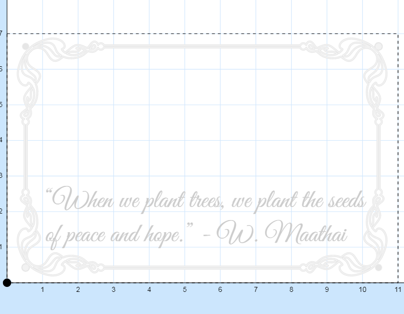

This is what I have right now. As I said at one point, I’m going to redo this as the cut depths vary since I didn’t flatten the raw wood all the way first. I rushed myself since it was needed for this weekend.
