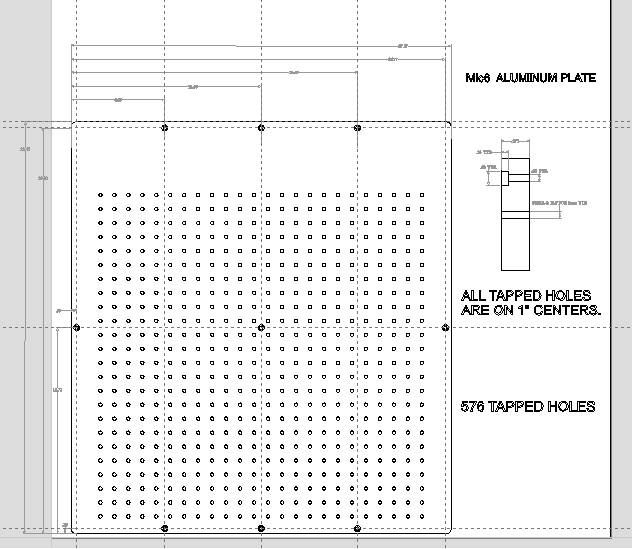

Don’t know if you’re interested or not but here is my design.
It says MIC6 but I used ATP5 cast fixture plate. They both have the same properties and tolerances, but with the ATP5 you’re not paying for the Alcoa name.
