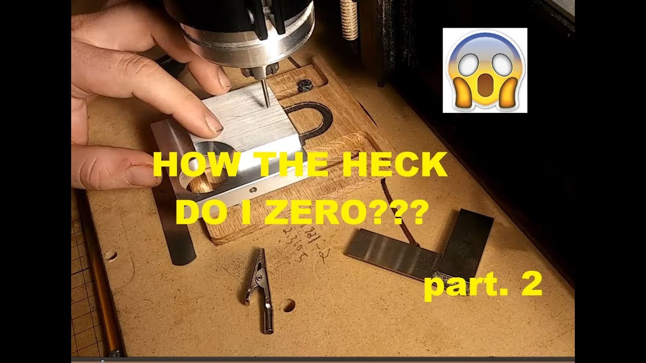

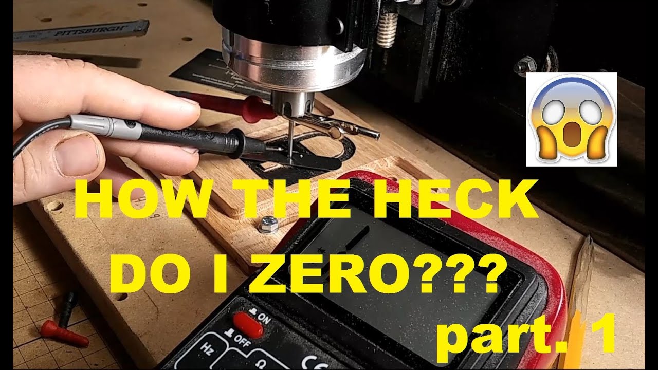

I did use the multi-meter trick.

Yes I have seen your videos.
I have a zero touch plate from Charley.
I have tested and the zero touch plate works perfectly
Its too large for this wooden disk.
I am going to see about milling a smaller version this weekend.
