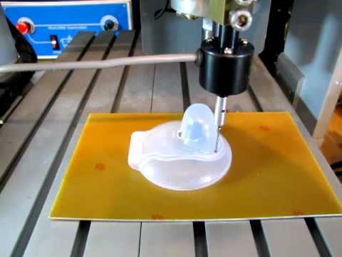

One of the few controllers that will so what you want aside from MACH 3 is the Planetcnc controllers. They have stand alone software and one of the major aspects is built in functionality for a 3d digital probe from making 3d models with a touch probe. The system is a bit more involved as it needs stepper drivers and such as they are not built in. But this does allow you to tailor your drivers to your steppers and to have a fully digital stepper system with DSP drivers. This is one of the few systems that will allow you to use a probe to import a 3d touch probe model and then process the data into something you can then turn around and mill out again. The system is not cheap, but it works great. It is a bit overkill for most folks but I run it on my larger mill (21X37X8) and it is very nice step up from the TINYG I run on the Shapeoko. You can also look into the touch probe from Wildhorse.http://wildhorse-innovations.com/index.php?_a=viewProd&productId=80. The thing about a touch probe is that it must be part of both the hardware system (connections) and the software system for 3d mapping.

a visual on digitizing with Planet Cnc control for others:
the Planet CnC MK 2 and Mk2/4 boards support digitizing probe. Which do you recommend for X Carve?
This answers many of my questions
http://www.planet-cnc.com/index.php?page=faq
I would look at the MK3/4 for the X Carve. Is has everything you need and still a bit of room to grow with. A MK2 would work if you wanted more outputs for things like vacuum and the like. I went with 4 Leadshine DSP drivers for my large mill (21x37x8) with dual Y ball screw drives. On the X carve you can go with some of their smaller drivers and have a great system, but they are not so cheap. The PlanetCNC drivers would work fine also. For the type of work you are doing you need to look into the 65mm 1.5KW spindle to reduce weight on the gantry instead of the heavy 80mm version. On my trip to inventables last week I checked out there R & D rig X Carve which is running a 65mm .8kw VFD spindle. It seemed to be working fine and I saw some of their milling off of it. For what you are wishing it do your tool paths and end mills are far more important than just your drivers and controller. If you can swing the DSP Leadshine drivers then I would go for them, you will love them and it will really let you do some very good tool paths with ease. But over all the PlanetCNC MK3/4 board and the Output board with relays to control the spindle from Gcode would about be all you would need on top of the drivers. That very same system could then be moved to a larger mill if you ever needed too.
