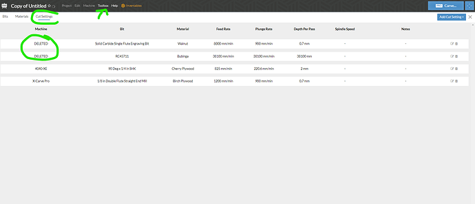

My cut settings in automatic are stuck. I can change bit size and or material and it still shows the same automatic ( suggestion). It use to change per bit and material selected. Suggestions? Thanks
Shows this all the time
Those are default setting, if you like to make changes click on manual.
Are these inventables bits or custom enteeed bits?
What type of material is selected?
And which cnc machine type was selected for this profile?
Likely youre selecting a combination that is “untested” and those are all entered identically and the user would need to select manual and enter custom settings, or assign custom sertings to that bit/material/machine within the toolbox (link at the top.of easel)
You can see your custom saved settings within the toolbox :toolbox:
Its stays like that no matter what material or bit is selected. It use to work. now its not. I do use custom most of the time.
For custom bits IF the machine was changed, like IF easel forced you to redo the machine setup, than the bits will not be re-assigned to that new machine profile and will say “N/A” or “DELETED” under the machine here, you will need to go to the toolbox and select Edit on the right side, select the correct machine, then save… For each custom bit parameter.
