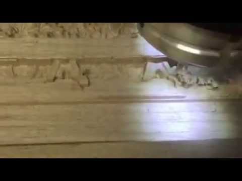

And here is what the carving looks like with just a coat of sealer on it I hope that when I put stain on it the details will come out. If anyone has any suggestions about the best way to stain/finish it please let me know.
The rough cut took about 30 minutes with a 1/4 inch endmill and the detail took about 2 hours with a 1/16 round (at 100 inches per min)

I said sealer, it is actually just the Minwax pre-stain conditioner, I have found that applying a coat of the pre-stain helps even out what ever stain eventually goes on.
Yes I imported the STL into Vcarve and made it fit the size I wanted.
