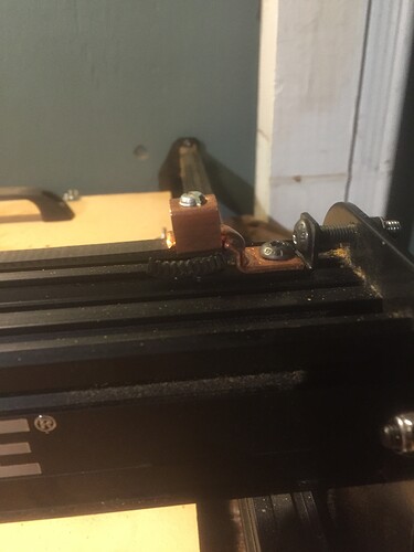

Here my Solution to the Belt Tightening. Purchase some ground copper clamps 14/4 mount them in place of the belt clips. The center screw on the ground clamp holds down the belt from slipping then just tighten the tightening screw.
