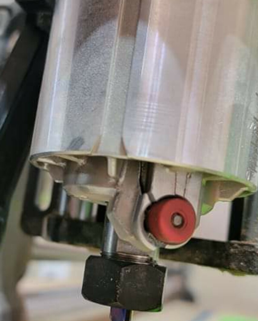

Just got my Makita router after 10 years of using a DeWalt. There is a very nice pin that slides into a hole in the shaft of the Makita. If you depress that pin with your left hand and the wrench on the collet with your right it works really well. However You need to hand tighten the collet on the bit to the extreme before before you tighten with the wrench.
Do NOT use the button in conjunction with a wrench the button should only be used to assist with hand tightening to snug up the nut prior to using wrenches to apply torque to hold securely and to break the nut free.
Do NOT use the button to tighten or loosen the collet nut like that, unless you want to crack the housing.
The various cnc FaceBook groups that run this router are littered with photos like this one as a result of this action.
Looks like someone did not pull the button out when they turned the router on. That is the only thing that kind of torque required for the fault in the picture. Unless of course if you use a 2’ long cheater bar.
