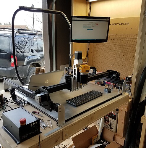

I used 3/4" EMT Conduit, just a 5’ piece of it straight from the hardware store electrical department. Used their pipe bender right there in the aisle to put two 45 degree bends in it, and grabbed a couple of the mounting clamps to go with it. Zip ties to hold the vacuum hose (grounded) to it.

Thanks for all the great tips. I think I prefer something a little neater looking than a bungee cord from the ceiling, and this boom arm that Lee has made looks pretty nice.
Lee: How did you mount the monitor to the boom arm?, That’s a great ideal!

Exactly what Robert said; they don’t bend them for you in store, but they turned a blind eye to me using the bender myself. It’s stronger than 45 degree elbows would have been, since it’s still one solid piece of pipe. This is what you are looking for, it’ll be on the same aisle as the electrical conduit: https://www.homedepot.com/p/Klein-Tools-3-4-in-Conduit-Bender-and-Handle-56207/100660160
The monitor is on a swingarm mount I grabbed off of amazon for 13 bucks, works great. Most monitors these days have 4 holes on the back in a square configuration, it’s called the VESA mounting standard. Check if your flat screen has one and then grab one of these:

2nd Edit: These are the hangers that I used to hold the conduit. They keep it secure while still allowing the whole thing to rotate over the center of the cutting area easily. And yeah, I drew a vertical line on the side of my cabinet with a level and just spread 4 of them out somewhat evenly, with a block at the bottom, beneath the end of the pipe, for leverage. https://www.homedepot.com/p/1-ACC-Steel-Conduit-and-Pipe-Hangers-5-Pack-26781/100161284
