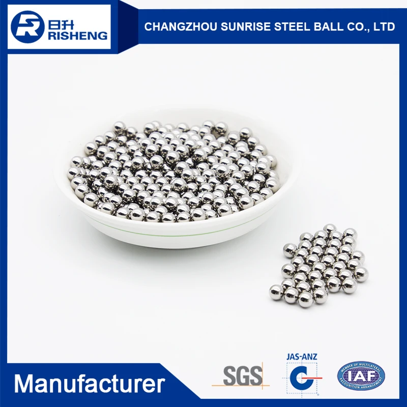

Just curious. Seems like a 6mm sphere is a bit big for this project. No?
maybe some small steel shot?
maybe this?
2mm plastic balls
If you want your Braille sign to actually be ADA compliant I don’t think of the suggestions made so far will work. Google ADA compliant Braille. It is very specific on size, spacing, height, width, material, etc. At my work we use a round bottom end mill to drill a hole just deep enough to press fit hard plastic Braille beads into the hole, NO glue. That’s not the only way to make an ADA compliant sign just the only way to make one with a router. I can find you a source for the beads if you like and even some tips and tricks if your interested.
