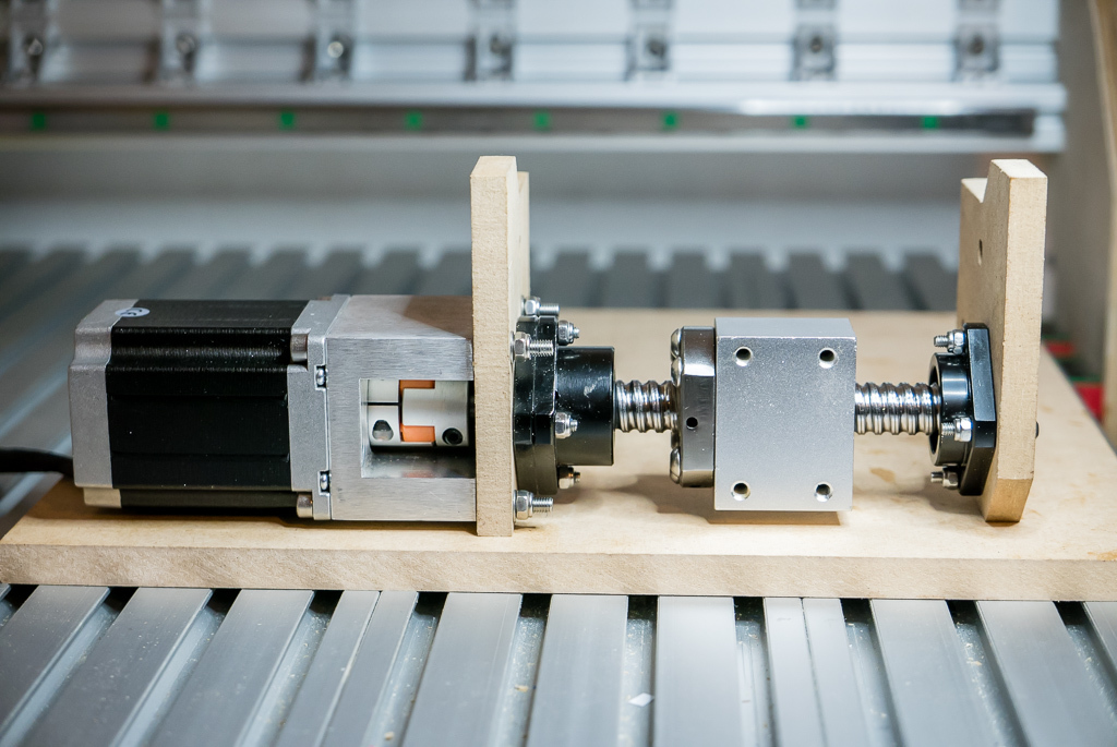

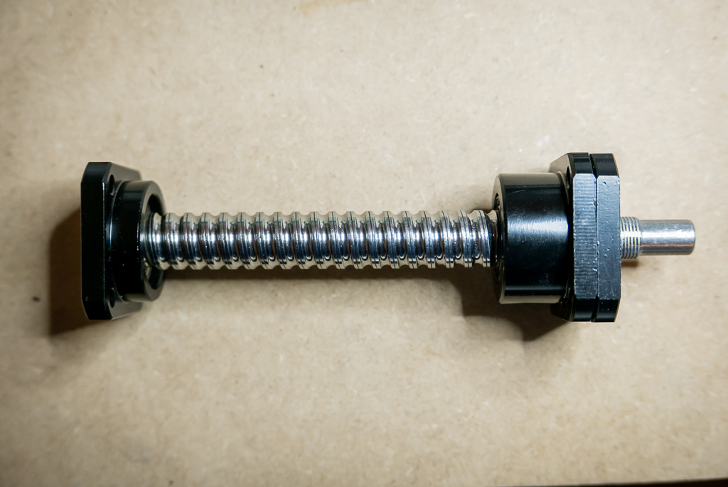

One of the most important pieces of the build is not going to be part of it.
It’s a sample ballscrew machined to the bearing block specs, which btw came today. I am not building the machine around specific/factory ballscrew lengths. I am sizing the ballscrews to fit the machine. Its purpose is to test fit, prove the theoretical/estimated dimensions and prevent a $150 mistake. If I order custom size ballscrews and they do not fit, unlike shoes, I cannot return them and ask for a different size. I call this the insurance piece.
My wiggle room is what I gain by swapping the fixed side spacers (shown below), i.e. their thickness difference: 0.8mm.
I could have picked a more forgiving type of bearing blocks to mount on the extrusions (BK12/BF12), but I opted for the ones that mount on the plates (FK12/FF12) in order not to sacrifice X & Y travel.
The spacers themselves seem 5mm so there is a lot of error margin on the length if they are too long. Alternatively you can make shims between end plates and bearing block if the shaft is too short. This should be enough to prevent that $150 mistake.
Seems a pretty short ballscrew that insurance piece, maybe for a speed clamp?
If I recall correctly, they are 6.3mm & 7.1mm. So, theoretically yes, I have more room. I can think of two approaches in case I miscalculate (despite my sample) and fall out of range.
  • Re-spacing
  • long shaft: sand the diff on an existing spacer
  • short shaft: add M12 shims
  • Block re-positioning
  • long shaft: carve pockets on the end plates for the blocks to sit in, deep as the diff
  • short shaft: add M4 shims between end plates and the blocks, thick as the diff (basically, what you said)
Hopefully, I wont need to.
The setup I had in mind (blocks outside of plates) when I ordered the insurance piece required in paper X+63mm length; i.e. 63mm extra length of ballscrew for X inner wall-to-wall distance. So I got 163mm to test for 100mm inner.
I have since switched to another setup (blocks inside of plates; easier for motor mounting, less motor protruding, different discussion), which in paper requires X+26mm. The insurance piece shows X+25.5mm.

The ballnuts came.
I have to confess that this was a big gamble. Well, big in terms of the delay (it almost took 2 months), small in terms of cost. I was willing to test if I could get three ballnuts with metal deflectors for a total of $32 (shipped) vs the plastic deflector kind I could find locally for $40 each!
The gamble was matching ballnuts & ballscrews of the same spec but from different factories. With such a tight fit there was no guarantee that they would work together.
To take it one step further and to satisfy our curiosity of how things work (and make sure that nobody messed up in the assembly line) let’s take it apart and repack it. I had an aha! moment earlier today after googling images like this
and was confident about trying it. Here are all the components: body, deflectors, balls, seals and a plastic pipe to keep everything together when a screw is not inserted.
I’ve seen videos of people feeding them from the top with the screw in place and twisting gradually. It’s scary not to be able to see what exactly happens and to make sure that no balls fall in the between the circuits zone (which will cause a jam). The method I followed was one ball at a time, one circuit at a time. Grease for greasing and for beating gravity too.
First circuit done. Btw, it’s a 1605-3 ballsrew, i.e. 16mm OD, 5mm pitch, 3 circuits.
All circuits in place.
Sleeve fitted. This facilitates inserting and removing the screw without knocking the balls out of place.
Ballscrew in, seals in place. Turns smoothly, no play, great fit! Second proof provided by the the insurance piece.
Plus ballnut mount.
Test Y axis drive assembly with temporary Y plates that were cut a couple of days ago.
Btw, here’s making sure that there is enough clearance for the flexible coupler’s spider between the motor and ballscrew shafts. Third proof provided by the the insurance piece.
I believe we are now ready to make a drawing and order the ballscrews in appropriate lengths.
